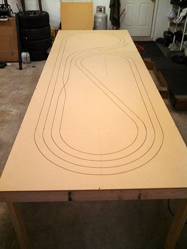

This track?
It has been repainted, however there still have been issues with dust that the owner is blaming on the cat!
RichD
Posts: 1885
Location: East Haven, CT
Re: Track paint
Postby SRQSloter » Thu Mar 20, 2014 5:11 pm
Yep. That's the one. So he's up and running now?
