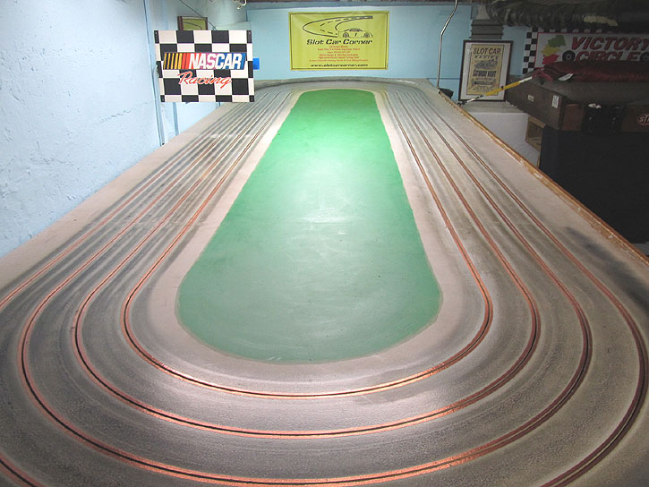

Well...no time like the present to start re-taping.
6 years and 6 different sizes of tape tested. The verdict? Any tape will work.

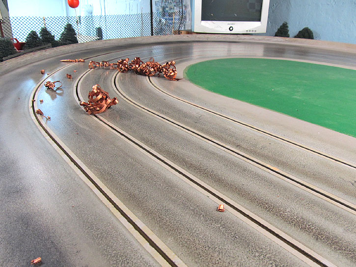

But with crawling up and down on the track, I have broken it and patched it more times than I want to admit.
SO...it's time for fresh pavement :)
What a mess. A good straight scraper blade is YOUR tool for this.
Progress will be reported in time.

If it was me I would consider switching over to braid. Several of our tracks that originally were taped have been upgraded to braid. The modern method of using double sided tape to stick down the braid is much easier than the old method of using contact cement. The gains would have to be routed and painted, the tape does not stick to bare wood very well. Slot Car Corner has the bit for the gains, the tape and the braid. A tape roller is nice to have as well.
