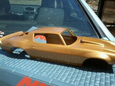

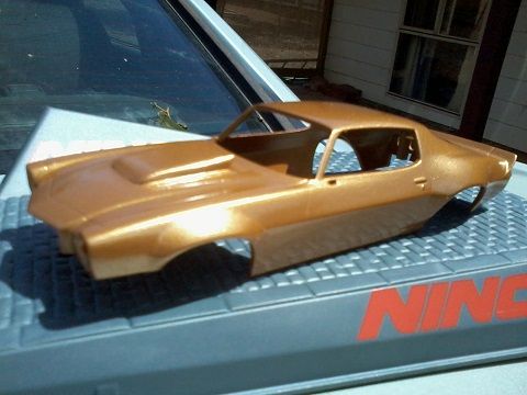

Ok, made a little progress.
It seems that this car ran in about a million different configurations and changed race to race. The hood scoop was more like an A9X torana one at one stage. So after rifling through my box of bits and Bobs I found a blanking cover for a switch from my days at Mazda (Never throw anything away) this was about the right shape but a little big, so I sectioned it and glued it back together and there you go.
Grafted it to the Camaro and here's where we are at - Looks a little blingy at the moment, but a few decals and stripes should have it looking more like a Camaro and not something that should be hung on a chain around a rappers neck.
So far so good. will post more as I go. :D

Postby dreinecke » Fri Feb 21, 2014 6:56 am
Ted - FANTASTIC!!! WOW is this thing going to be a looker!!! I love the re-use of the switch cover for the scoop. You did that perfectly!
What color is that?

Postby Reslotted » Fri Feb 21, 2014 8:10 am
Contessa Gold, Dave.
