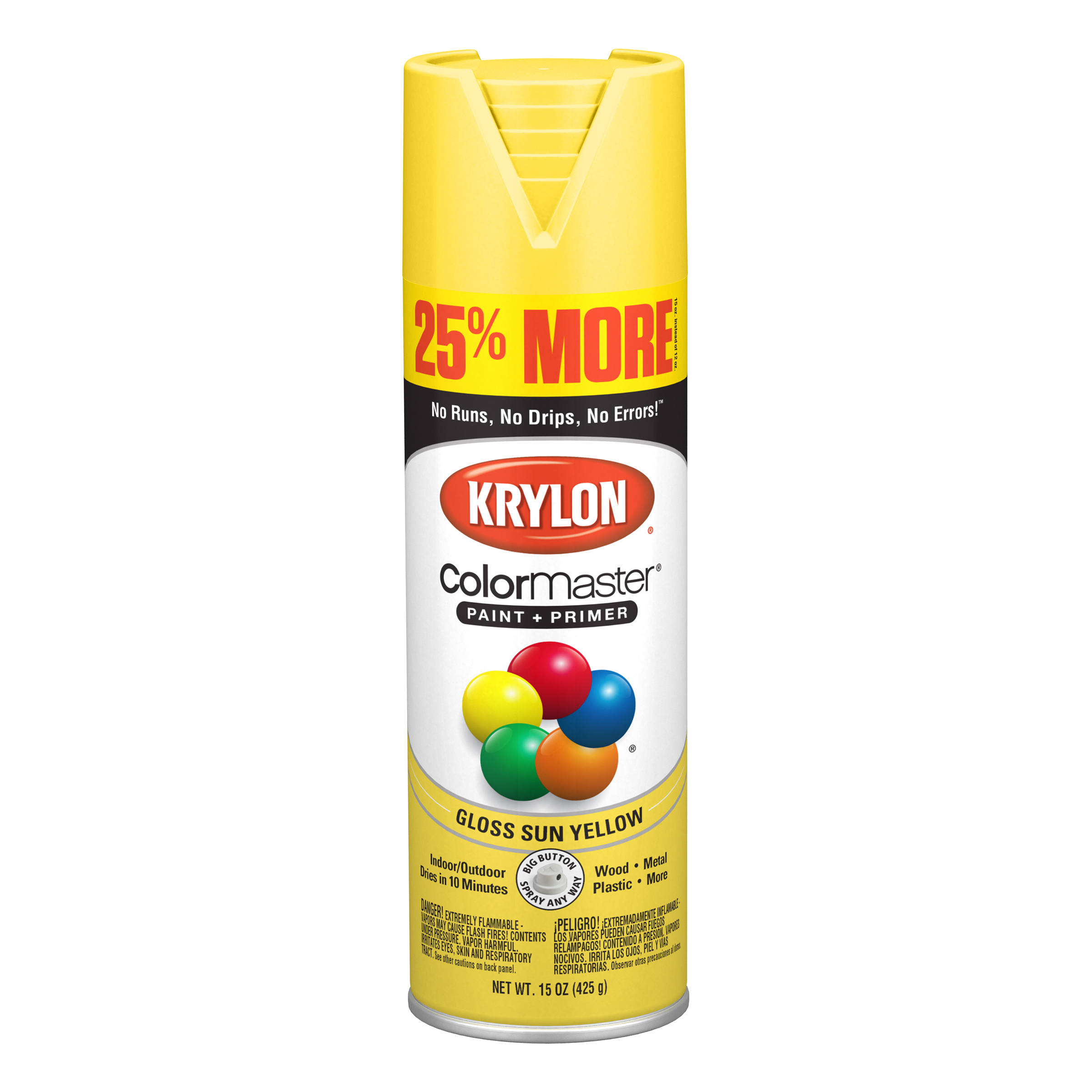

I really like how vibrant the yellow is in this photo and would like to replicate it. I checked out local stores, including craft places like Michaels and A.C. Moore, looking for the brightest yellow spray paint I could buy. The 'official' name for the color I'm after may be safety yellow, which I'll probably go looking for at our local Sherwin-Williams paint store today. Best I could get on a Sunday was Krylon Sun Yellow at Walmart.
Late last night I put a test coat on a bare tan-white resin body and it was okay, but not vibrant like I was hoping for. While exploring shades of yellow on line I read about how the base coat can effect the tone of the yellow paint on top of it.
My question is, what base coat would you guys into modeling recommend under this yellow to help it shine? All feedback welcome.

The Krylon is pretty good for an enamel and it actually dries with no tackiness after a few days. I hate paint that stays soft and doesn't dry all the way thru. Testors makes a couple nice yellows in lacquer, which you can clear coat with lacquer or your clear of choice. I doubt if the undercoat color will make much difference if you put much yellow on it and get solid coverage. If it would make a difference, I would put some silver as a base coat. Check the options of yellow that Testors offers. They have a Chrysler yellow that may be what you want.

I went looking for Safety Yellow at our Sherwin-Williams paint store today but all they had was the same Krylon Sun Yellow paint I already got. I've decided to go with the Sun Yellow but will be thoughtful about the base coats using the feedback provided. For starters I'm going to find an unused body to prime with white on one side and grey on the other, then lay down a few thin coats of yellow and see if I prefer one side over the other.

One of my problems is not knowing the difference between a lacquer and an enamel. As a kid I was able to get small bottles (35 cents?) of Testors paint and paint my models with a brush. As an adult when building a body for a slot car I'd just go to the nearest hardware store or department and grab the color I wanted, and didn't have any problems. Of course I mostly just wanted the car to be a certain color and wasn't overly concerned about how it would be judged as a model. My recent Cyclone builds have meant trying to replicate some nice classic cars with memorable paint schemes and decal configurations, so now I have higher expectations.
I just did a bit of research and Krylon ColorMaster spray paint is most likely, probably, a lacquer. Check out this query and response on Google:
Is Krylon ColorMaster enamel?
Krylon ColorMaster™ contains durable covermax® technology which provides a smooth, even coverage and brilliant color. ... Krylon ColorMaster™ is the perfect choice for both indoor and outdoor projects. Dry to touch in 10 minutes or less, to handle in 1 hour.
In another exchange on an RC forum Krylon replied to a question about using their own clear coat for their paints and said, no, that's likely going to cause wrinkling. Forum users said they weren't having problems with the new formulation of ColorMaster paints until they put a clear coat on top. The biggest complaint was Krylon not having a warning on their clear coat that it isn't compatible with their indoor/outdoor paint sold on the same shelves. The reason I buy Krylon spray paint is because it's everywhere in a lot of colors. I like being able to see the color of the cap to know if it's what I want. Krylon ColorMaster claims to be formulated to bond to plastic which I've found to be true.
I'm going to use the Krylon ColorMaster Sun Yellow paint I bought this weekend for some testing and hope to paint a Cyclone body with it once I settle on primer base coat(s). If it turns out as hoped it'll be the clear coating issue that'll really freak me out. I may skip it or try light coats of Future with a brush.

Krylon is an enamel paint and would not be safe to re-coat to soon every enamel goes through a drying period thats not safe to apply more paint usually a month I have done some really nice paint jobs with krylon after the yellow has been applied give it few days before adding decals so not to trap solvent under them it will make a decal wrinkle if done to soon floor wax would be a great option for clearcoat

Postby slothead » Tue Sep 10, 2019 7:00 am
This is from the Krylon ColorMaster website:
DRY TO TOUCH: 10 minutes
DRY TO HANDLE: 1 hour
RECOAT WINDOW: Within 4 hours or after 24 hours
APPLICATION CONDITIONS: 50 to 90 degrees; humidity below 85 degrees
I'll probably wait about an hour between base coat and topcoat(s), then apply 3 thin topcoats 10 - 15 minutes apart. I'll let it sit for 1 - 2 days before applying decals. Then another few days before thinking about trying Future as a clear coat.

Krylon Sunrise Red is a nice red that is great match for 1935 Lionel red. I used it to restore a 1935 Lionel Commodore Vanderbuilt passenger train. It worked great and dried in about 4-5 days. I didn't attempt a clear coat. It is an enamel paint, even if it is quick drying and trying to clear coat it may lead to failure. The safest bet is to use Pledge for the clear coat.
Spray lacquer is a hard paint and uses "hot" thinner to make it sprayable. Spray enamel is a soft paint that uses a "milder" thinner to make it sprayable. Enamel does not dry thoroughly and get hard like lacquer does. When lacquer goes over enamel, the "hotter" thinner penetrates into the enamel and makes it bubble up and split open. Best to stick the the same paint all the way thru any job. Pledge clear coat is safe with any type of paint.
I try to keep nothing but lacquer and I have no problems any more. Testors and Tamiya are expensive, but those big cans while cheaper, hardly ever get used up or go bad on the shelf. Lot's of guys use Duplicolor touch up spray, which is lacquer also.
