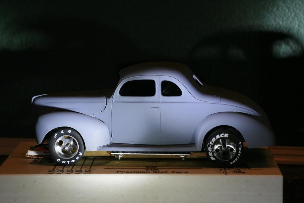

Timing is everything, I'm sanding and priming one more time before I make my first attempt using a airbrush. I am going to try the acrylic paints. While the paint dries it's time to work on the bumpers and maybe change the front half of the chassis the way the articles in the scratch build section explain modifying a H & R chassis. As I run Carrera Digital 132, I put in a digital module, tested the car and found it runs great. I have the 26K motor which is more than I really need.
