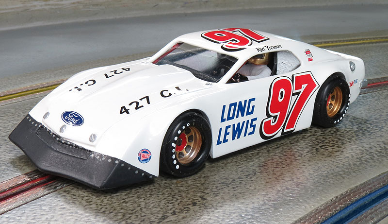

Postby turbokev » Mon Jan 12, 2015 6:37 am
I'm just finishing up my Late Model Sportsman build and I want to give it a clear coat..
It's painted with just Testors white enamel paint.. Then it's got ink jet printed decals
that I used Testors 'decal bonder' on to set them and waterproof them so I could apply them to the car.
That all went great, the decals did not run and look good..
What should I use to seal / clear the whole car now? The decal bonder appears to be nothing more
that a laquer clear so I considered that, but something in the recesses of my mind is telling me not
to spray laquer over enamel?
I don't want to screw up the car.. what are my options?
I hope to run over to ACE Hardware later this am to pick up something.. they have a small model
paint selection so maybe they have a Testors enamel clear, but I'm open to Krylon, Future, whatever..
Thanks,
turbokev

Thanks everyone.. Just got back from a trip to the stores..
All I could find was a spray can of Testors 1261 Gloss Clear Coat.. 'Spray Laquer'
No other gloss spray cans, no Future.. I really don't want to have to wait for an internet order..
What about Laquer over Enamel concern? I can't remember if that's a no no or not?
Could I use this Laquer Gloss Coat ? (I got it just in case)
