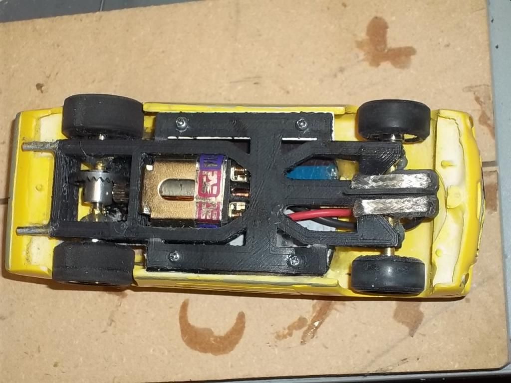

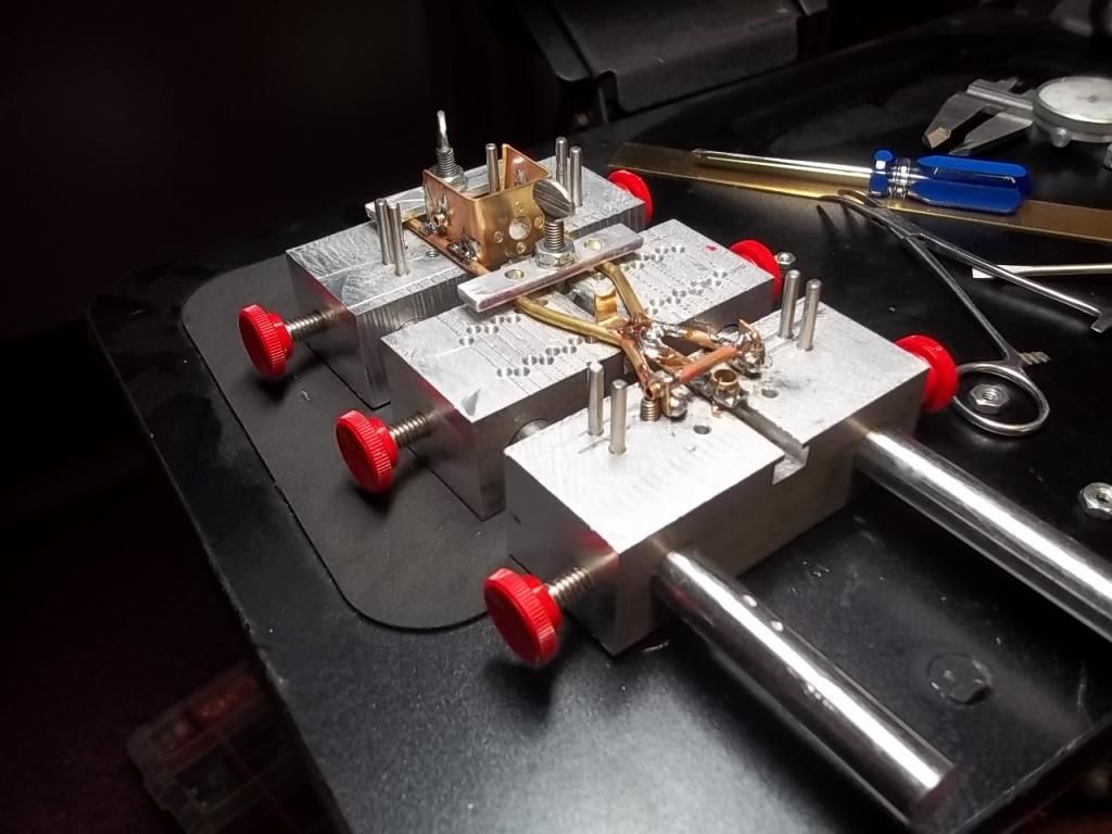

At first I thought I make a brass chassis for this little beast but after completing it I noticed it was way out of alignment on the motor mount. Image So I decided to get out the CAD program and printer and start a plastic one instead. That turned out to be a little better. After some modifications to a plastic card I was able to put a PM driver on it and install in the body along with the chassis. I also beefed up the plastic chassis in the flag area so it wouldn't be awaiting work like my One Ugly Falcon is. Image
Anyway I am happy with the results for with the parma deathstar motor it only tips the scales at a hefty 118.8g. I used Parma gears, slotit wheels and axles and PG tires. First run around the track turned a 8.04 which I don't consider to bad.Image

Don't give up on the brass chassis. You say your misalignment was in the motor mount. Did you happen to drill your axle holes before you bent the mount into a "U" shape? If so, next time try placing them after the mount is bent. You should be able to more accurately locate them then.

I didn't do it my normal way, I took a short cut. What I normally do is print out the motor mount full scale, cut it out and glue it to the brass. Then I punch out the holes and bend it. Once bent, I then scrub off the paper and solder it on. I'm thinking of getting one of those miniature press breaks to do the bends instead of the pliers method.

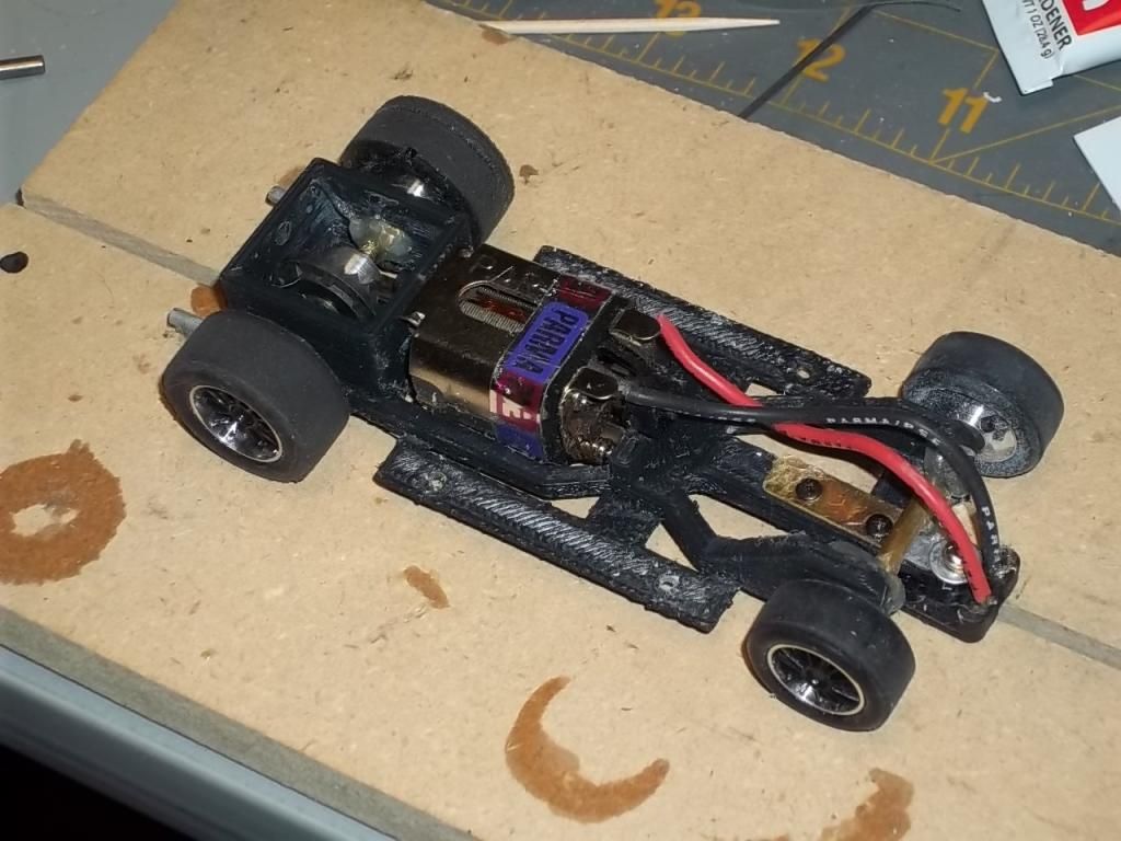

The plastic chassis. I tried to simulate the brass version as best as I could and left out the front suspension this time which I have add to previous chassis. Notice the brass stiffener for the flag. I thinking of filling the brass tube with JB Weld and then drill it out for the flag to get rid of some of the slop Image
There is a little flex in the chassis so I just mounted on the sides to take advantage of the flex.Image
