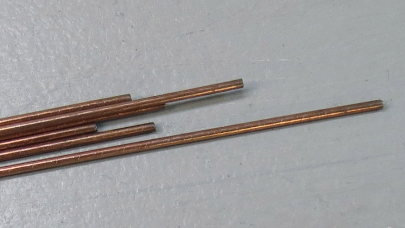

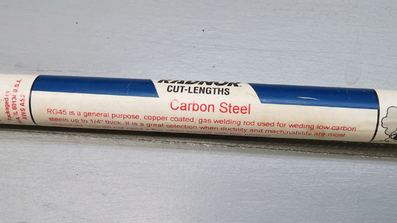

To make sure I am not making a mistake, here is what I was referring to. It is busy here working on projects and getting the old Skunkworks cleaned up for slot car royalty to visit.
This is the 1/16th rod we are using. Just standard RG45 copper coated material we get in the long tubes at the local welding shop.
It says you need no flux for brazing, but for soldering it needs it, or at least it sure helps the flow.
We use it all the time. I have never made a complete chassis from it, but my buddy Tom has. I use it mostly for nerf bar supports.
Using the flux with 60/40 makes it a very easy metal to use.
Apologies if I was talking about the wrong material.

So soldering carbon steel rods coated in copper.....if you sand off the copper then you should use a strong acid flux and probably more heat than when trying to make a joint with brass pieces.
Does that stuff bend easily? or is it quite brittle?
The stuff I use is brass looking all the way through.
