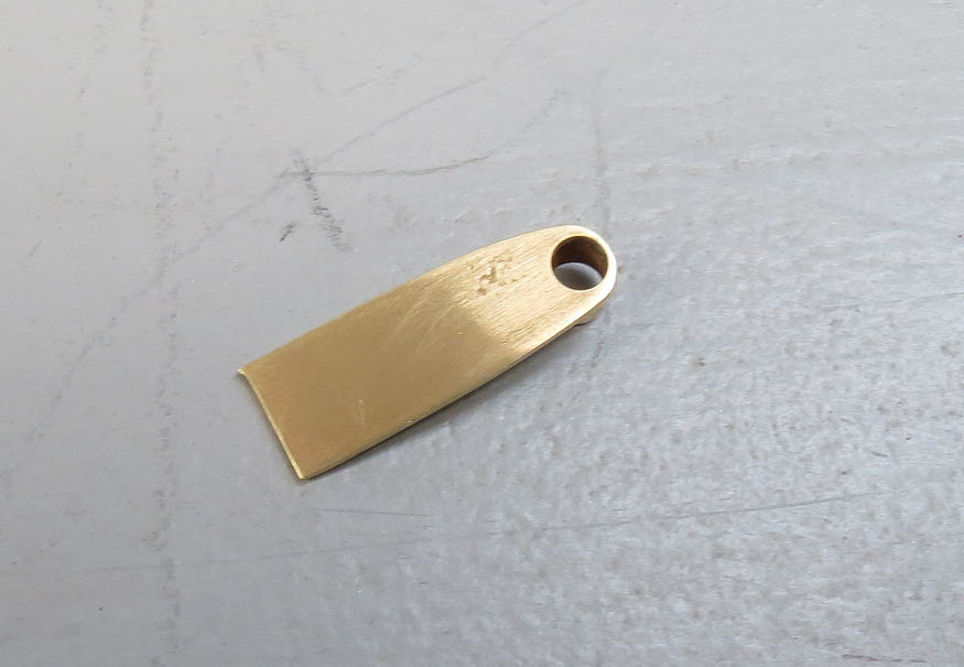

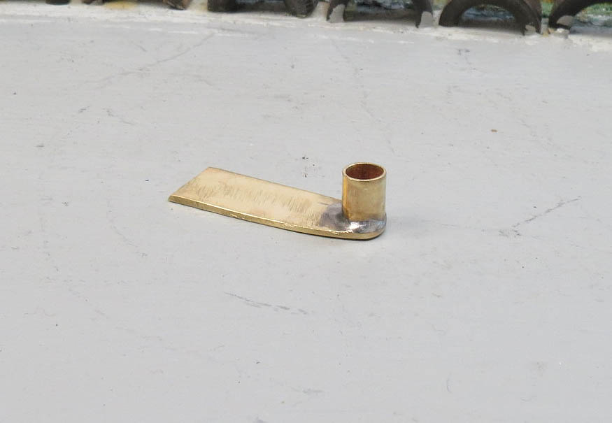

I use the ScaleAuto #1603 guides as they are good value and never break.
But Pappy is 100% correct.
On my builds, I make my own guide tongues using tubing or stacking brass channel to create a taller mount for the screw type guides.
Just a simple brass strip with some tubing. Then drill the hole.
Hope this helps.
