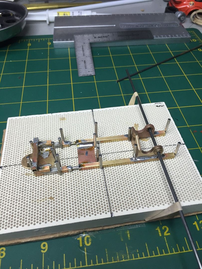

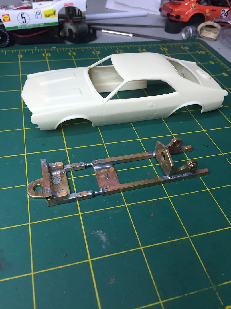

With all the inspiration and supportive info from HRW, I was able to build my first chassis. I am building it for my RMS '68 Javelin and the Trans-AM proxy!
I appreciate any suggestions and or comments, I know it is not the prettiest however a great learning experience.
I would like to thank Retro44, dreinecke, vtecfour and shotgundave for the informative posts and advise as I commented on their posts.
This is only one of the reasons I continue to be an active supporter of this wonderful site. Thanks to Harry also for his supportive comments as I learn this really awesome part of the hobby.

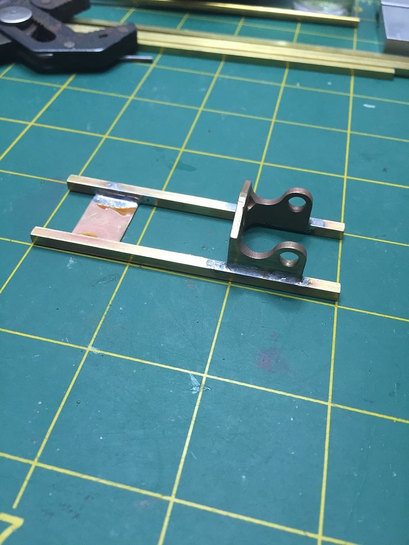

The beginning was easy, IMHO.
This guys was a bit of a buggar, but think it will work.

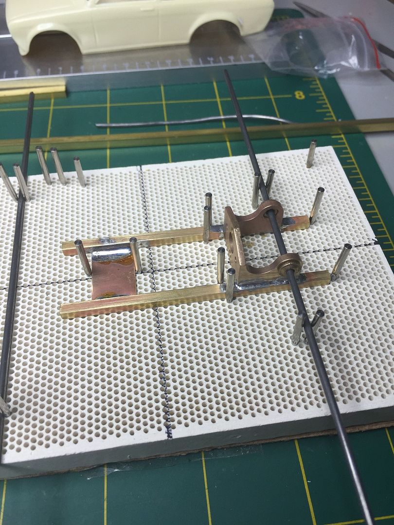

It did not work, as you can see. I needed to added another support for the front axle to obtain a proper ride height.
Once I went back and look at VTECFOUR's post on his NASCAR build to confirm I goofed. :text-thankyouyellow:
My guess is I was too excited to solder and missed the extra supports.
The wonderful AMC Javelin from RMS that will eventually be part of this build.

Hey, if it's flat, square and true, then 8t should work well.
I like your use of wire inside the main rails.
On the suggestion request, why not use another piece of wire, bent in an inverted "U". Then if you bend the end of the "U" up 90 degrees, your front axle will be secured. Just my opinion.
Keep up the great work

Interesting idea Florida, I had not thought of that. I have not bent a lot of metal yet, so not sure how that would be done.
It seems flat based on the base I used, but more will tell once I get wheels and guide set.

Thanks all, I think I used too much solder. Possibly just my haste, fortunately seems to have turned out good. Looking forward to finishing her up I. The next few weeks. (The chassis).
