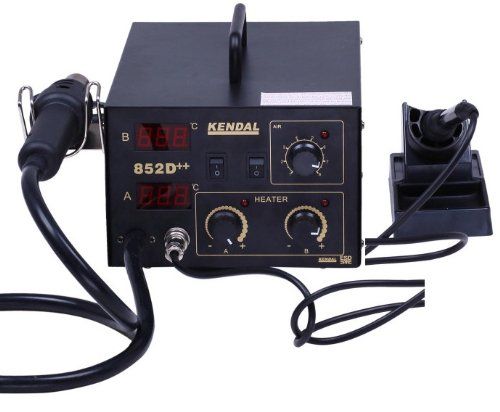

Postby KD11 » Fri Feb 13, 2015 4:14 pm
I just purchased this soldering station that also provides adjustable heat and air flow for de-soldering smd devices. I tried it on the styrene for making a roll cage and with a little practice this worked very will and fast. Image
