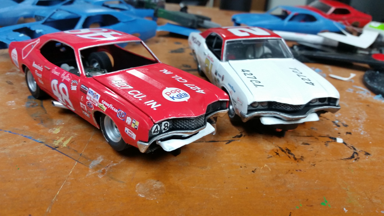

Still working on getting things to fit. The grill on the left is better positioned than the earlier prototype on the right. It is a very simple filing to prevent the hood from forcing the grill inward and backwards.
The 48 car has decals I partially printed out using white decal paper. I had to match the area surrounding the number 48 as closely as possible to the car paint. A little trickier than it sounds.
The street grill is too much work right now so the race car is going to have to do for a bit.

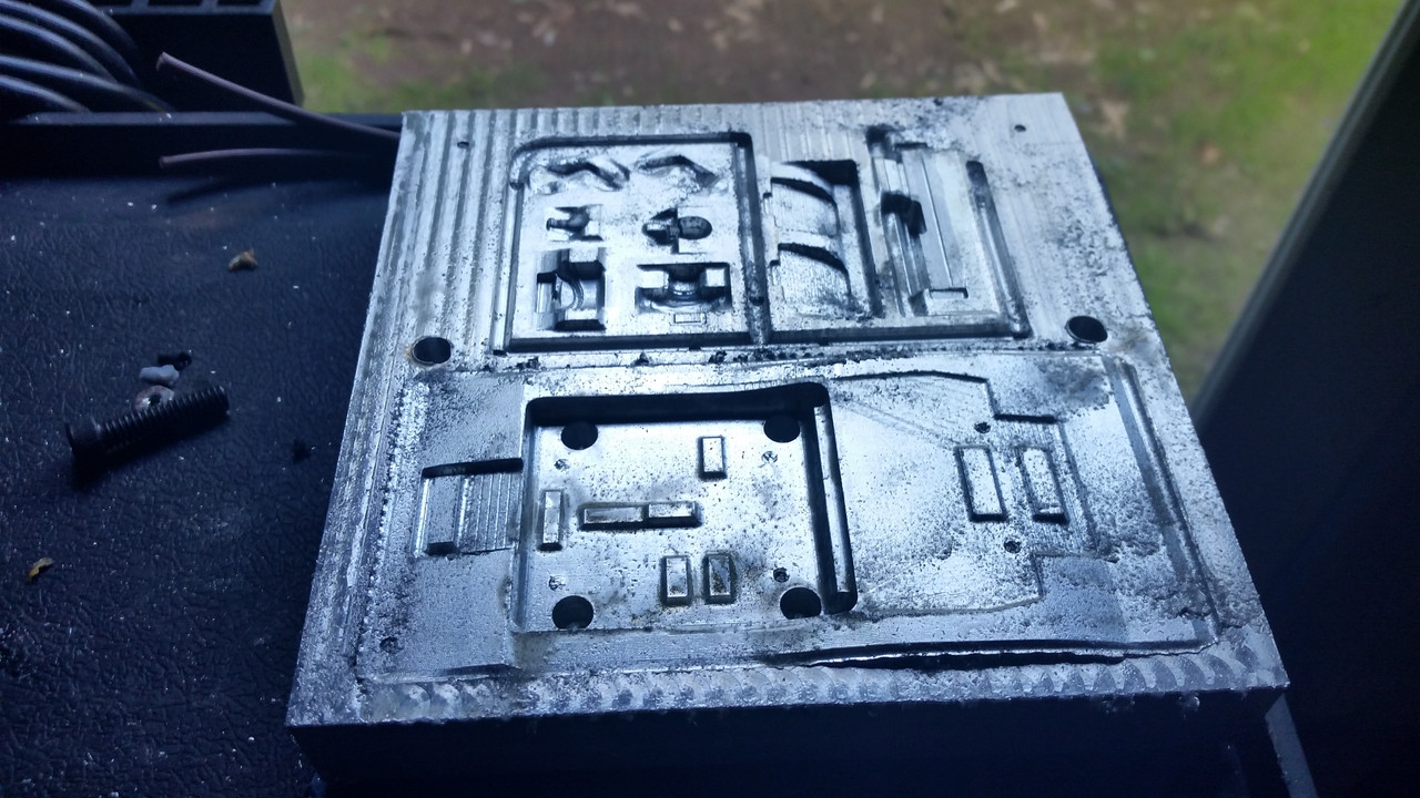

The first half of the interior is done, and you can see the 4 posts located on the bottom of the tray for fitting to whatever chassis you can cobble together. There are 2 rear mounting locations for fast back or regular bodies. REgular bodies will require a slight trim to the back of the tray, while fastback cars use the entire length of the tray.
This mold has the driver also. The other half is started, so interiors are on the horizon.
