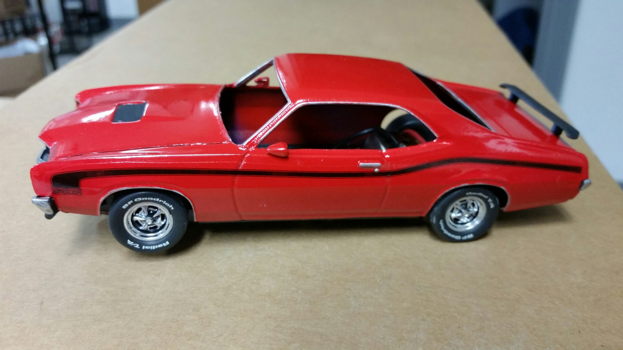

Postby proxieken » Mon Sep 17, 2018 5:56 pm
It has been a month and the basement is finally flood free for now. Lots of work but better than ever in the hobby room.
Making slow progress on things, I gave 6 bodies and decals to a friend who is better at taping than me and will post pics of his work when he is done. He is tackling the Darrel Waltrip brown and gold car and I wish him luck on that.
For now I am working on that accursed "war canoe" grill. This pic is of the street car version with the scooped hood and gun sight grill. The grill goes in so far the bodies do not set neatly on either the Pioneer Charger chassis or Carrera Torino chassis without a little surgery. Hopefully in the future I will learn from this and plan accordingly. The rear spoiler is not on this car but I will take another pic and post it with the pedestal spoiler in place. There is also a hidden headlight grill. Being a fan of lights I had to make the taillight section open so the car can have some brake lights someday. I am awaiting some decal paper in the mail to produce the stripes for on the street car.

Postby slothead » Mon Sep 17, 2018 8:44 pm
That red car with 'chrome' door handles and around the windshield looks great. Just saw a Cyclone at a car show yesterday and remarked it's one of my favorite body styles. I hope you get this to the point you're ready to offer some for sale. I'd love to be able make a replica of Wendell Scott's NASCAR.
