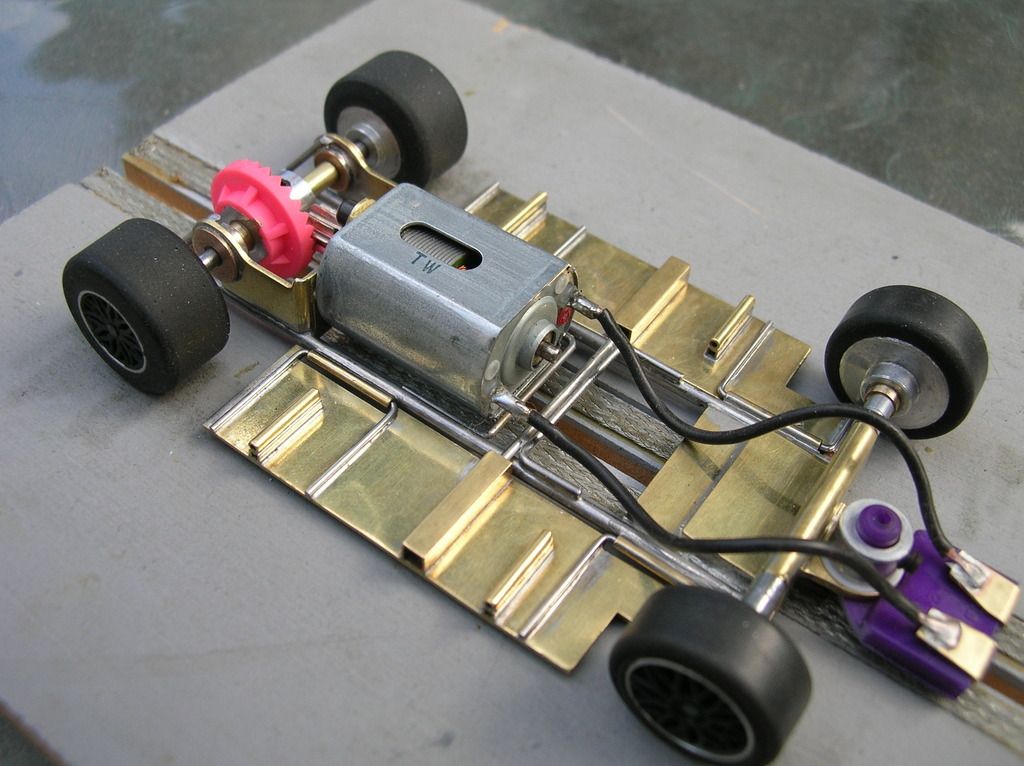

The chassis is an oldie, and not a lightweight, but having seen pics. of the tracks (particularly the hillclimb) I don't think a few extra grams will be a big penalty. It has had its "make me legal" refurb and is ready to go.

What is that motor and who makes that crown gear (I like the reinforcement on the outside of the gear ring)?
How do you like the PM guide? I=It's certainly advanced, but is the pivot point or the leading tip of the guide the important factor when considering the distance between the guide and the rear tires?

Allan, the crown gear is a Parma King Crown Gear. They're available in 26T to 35T. Originally made to fit 1/8" axles, they're also available with a brass insert to fit 3/32" axles. That FK type motor could be most any wind. Chris will know its origin. :)

Beauty chassis alrighty......clean and straight.
