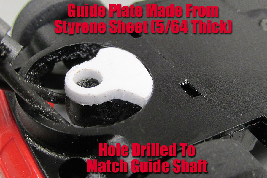

Got a little carried away, but when my buddy Tom shows up I get motivated.
All new SCC/Slot.it running gear. CB Design 14x6 wheels. Made inserts from original wheels.
MT Racing motor for classic style racing. Paul Gage rear tires. Made a guide plate and used PM guide with SCC braid.
Sanded bottom of interior tray to clear.
More than most folks will want to do. Just had the parts and wanted to see what we could do.
Lot of fun doing it and it runs very smooth.

Couple items worth mentioning, the gear you want is the NSR which is the standard size, not a Slot.it. The Slot.it diameter is larger and you have to sand the chassis at the bottom to clear.
