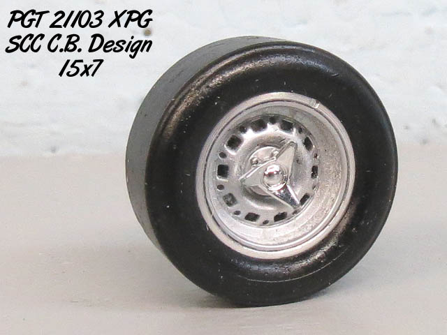

Just getting started in this car. Axle was bad and one wheel hub cracked a hairline, so ordered the little toys to fix the big one :)
Had the wheels come in and cut down the originals for inserts.
Tire/wheel combo is as close as I could ask.
Chassis & motor work now. Hopefully it turns out ok for our classic series.

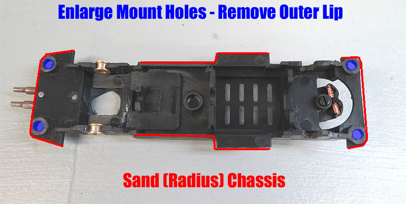

Postby HomeRacingWorld » Sat Apr 27, 2013 9:13 pm
Chassis Mods Part 1
Notice I removed material that is directly under the interior. I thought the interior was too close and possibly rubbing.
After removing it, I could see where I did not need to. So...live and learn.

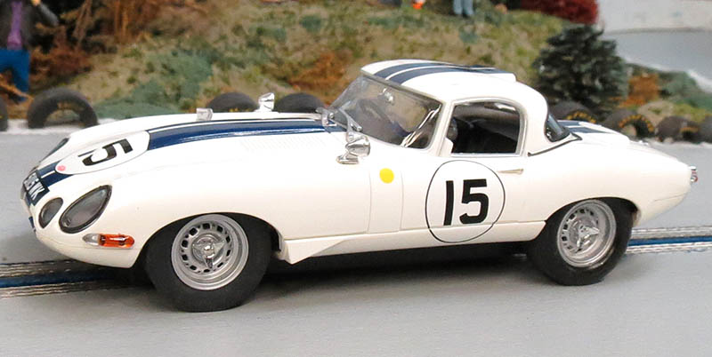

Postby HomeRacingWorld » Sun Apr 28, 2013 8:14 pm
Finished it!
Slot.it gear in the rear. MT Racing classic motor.
Run great to me. Falls right into our classic series. It runs right along with some of the inlines, not the fastest...but not the slowest either. Plus it is just one nice looking car.
Lot of fun getting this finally in the line up.

Postby Ember » Thu May 16, 2013 10:19 pm
Jag tuning has commenced with a vengence. Chassis trimmed and mount holes attended to. M/T-1 in place (thanks H).
You may notice I'm a little more heavy handed with motor shaft stabilisation than Harry. I only have access to a very thin heat shrink but it works well with a sleeve of 1/8 brass tube over the top.
It really is quite amazing just how much even this little mod can make to the handling of a front motored car. This mod alone was enough to turn a Caterham from undriveable without a magnet to something a little more manageable. Will take a lot more work to make it fun though.
