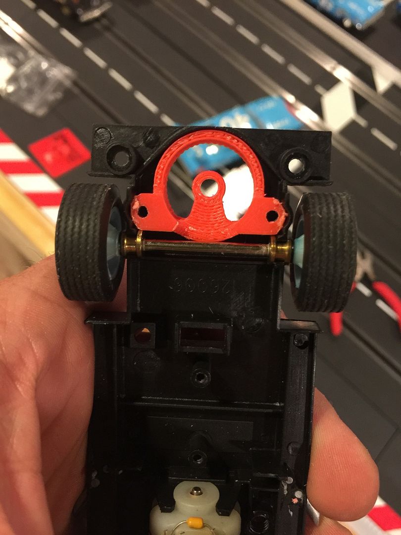

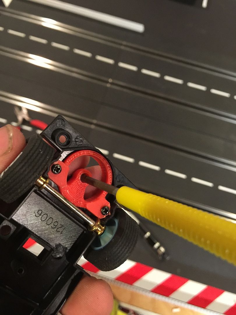

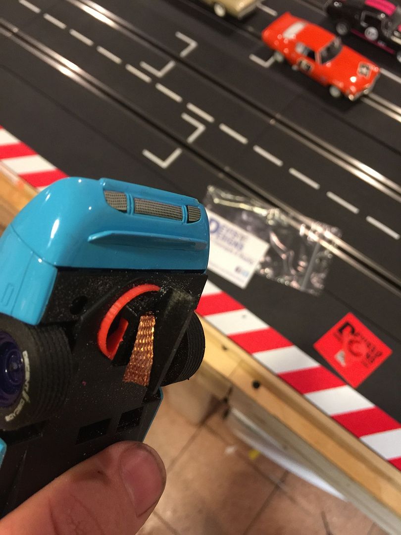

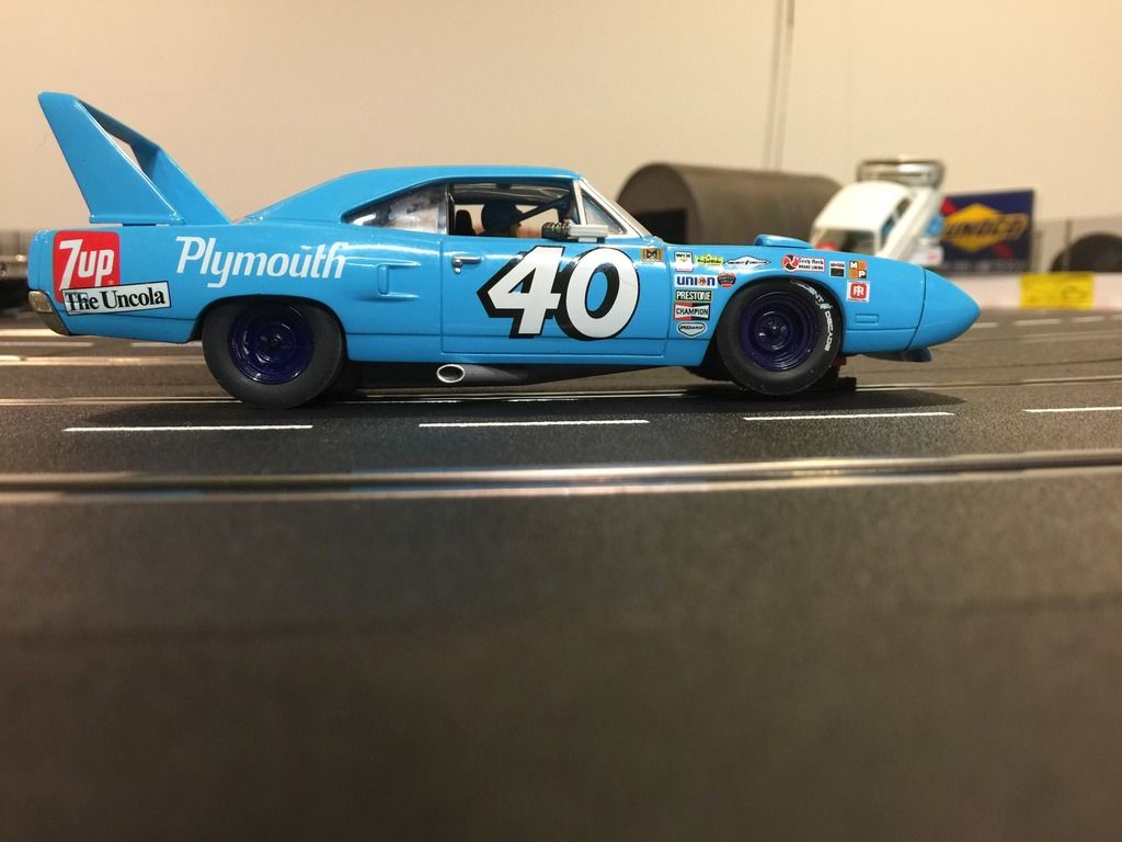

Postby Gameover » Wed Aug 19, 2015 9:02 pm
Ok so i have one of the two d3 guide adapters installed. I choose to do my plymouth superbird
I had no trouble with screw holes lining up but i did need to trim the outer edges of the mounting area around the screw holes so it could fit down the way it needs to.
I also needed to file the hole out so the guide could move freely. Now i used the d3 guide that came with my two adaptors. I plan on using a scaleauto guide with the second for comparison.
Both d3 guide and adaptor installed.
Re: Carrera Guide Adapter Version 2.0
Postby Gameover » Wed Aug 19, 2015 9:07 pm
I forgot to add that i spun twenty or so laps after the install and truly like how it handles. I will run some more laps tomorrow on it.
