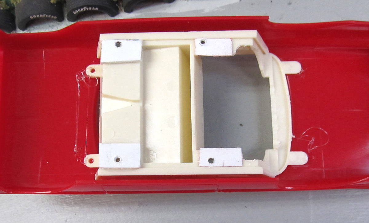

Showing the body mount system. I used styrene sheet sanded to the height I wanted and super glued in place.
I simply drilled holes in the chassis. Then held the chassis to the interior by hand and used a pin vise and drilled the holes.
Looks well enough to me.

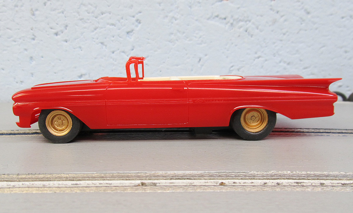

Just a slight "Daytona Rake". But made sure NOT to slam it on the ground.

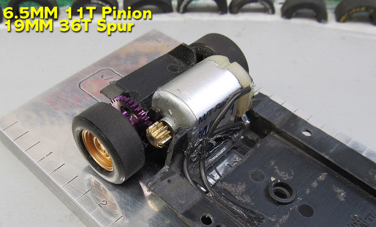

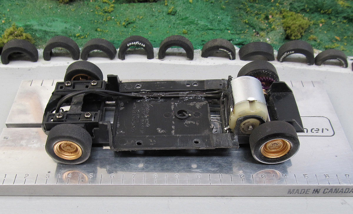

Chassis is up and running. Basic mods I used in the Monogram Tuning article except the MT-1 motor is here.
Trimmed away parts of the chassis that was not needed. I looked in the rules....and it didn't say you couldn't :)
The ratio we use here. Seems to work well on our oval, so will see how it works other places. It is smooth running and fun to drive. Hopefully others find the same results.

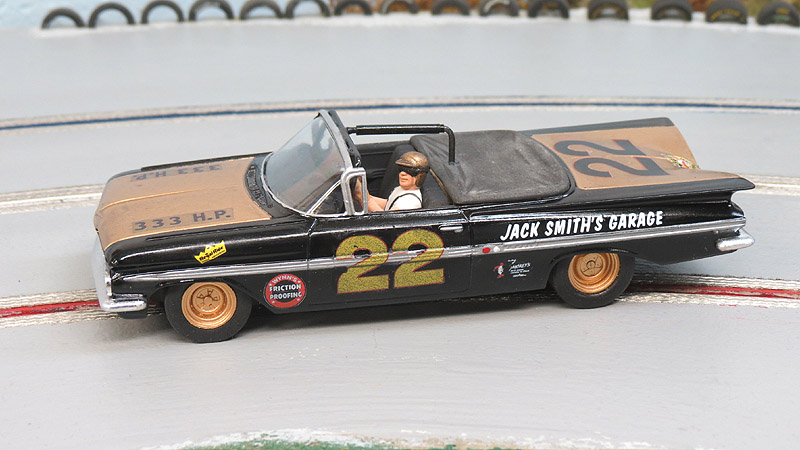

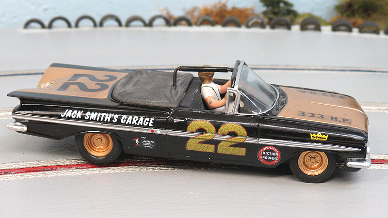

I was asked to put the finished model in the thread that was started for reference.

Harry, that came out great..looks good in the black and gold too. I know those are not usual colors you use so I am glad to see them on that car. :mrgreen: ;)

Nice looking build. I'm shocked that you would have used black and gold...I think you and Lee obsess over certain color schemes... ;)
