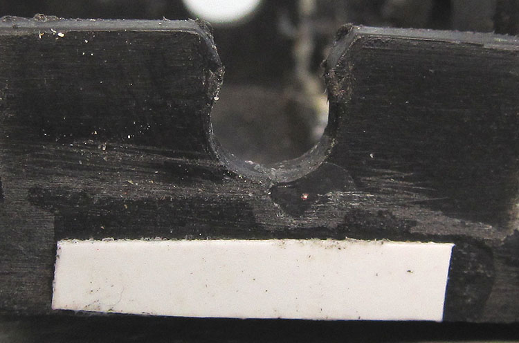

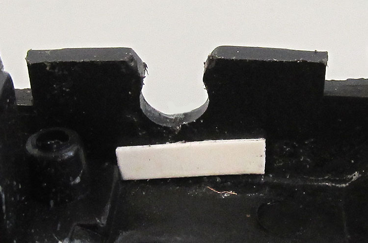

This old chassis has a crack in it right where the bushing sets.
I held it back in place and used Super Glue to hold it. Then used a very thin section of styrene plastic over it. I sanded the section first to score it so the glue had more to bite into.
Did the backside too. I made the braces low enough so the bushing flanges would clear.
Now to clean up these bushing mounts and get our new bushings in place.
Stay tuned!

Try running one of those dremel lawnmower blade sharpeners (like you get in the SCC bushing alignment kits) through the bushing holes first. My guess is that if it cracked maybe the hole was a little small/tight.
Hopefully this helps as I know the earlier Carrera has a different bushing, but I think the diameter is the same.
Burglar
Re: Old #17
Postby FootScoot » Sat Jan 05, 2013 8:26 am
Nice fix on the cracked chassis. I've had that happen, but didn't use super glue as the plastic on chassis' is a different breed. I used PVC cement with the styrene patches which really bites into the chassis plastic. The cement is the same stuff you use on plastic PVC pipes. It's cheap too and can be purchased a lot of places around town. :)

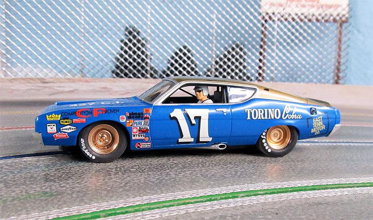

This one took awhile, but got'r done.
Chassis was cracked up front too. Found that out fitting the B-Nova. After all the glue and styrene were added, it took a good sanding to get the body to sit right and to get the front axle to ride correctly. I sanded out the front bushing mounts and just let the axle "float" while on the setup block and then glued in place.
SCC 17x8 Steelies, PG 22155 tires, Slot.it 27 Crwon and 9 tooth pinion. Stock motor.
The old fox is back though, ready for action.

What did you do with the balance, Harry? I always had trouble getting the Torinos to balance weight for good handling.
Re: Old #17
Postby HomeRacingWorld » Sun Jan 13, 2013 8:20 pm
Well, I lowered it a little in back. Just shaved the rear mounts flush with the bumper tabs. This really helps, even though it is only a little.
The big thing with the Fords is something Cheater showed me a long time ago: Open up those screw holes! They molded them slightly off and this causes a bad tweak in the chassis. Once you free it up, then the car starts to act right :)
