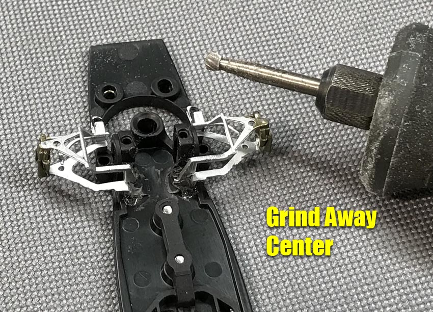

Just a quick one for those working on them. I wanted to allow increased room for the lead wires to minimize the pressure they make on the front axle.

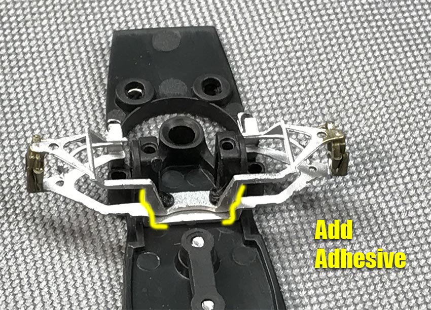

I just glued the detail structure so it was independant of the center.
Then I milled out the center. This really allows more room for the wires than you might think.

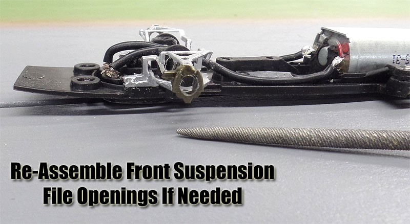

It's great to see fixes like these. I picked up the Graham Hill car, and the front end is a mess- the top and bottom don't mate-up properly which works as a brake on the front wheels, both on the inside of the wheel itself and against the axle. It looks like removing the detail parts, ling them up and reattaching them, and then reaming or filing them out to allow for unhindered spinning is the only option.
In my opinion the front end is the worst executed part of the car. The design is fine, but it needs to be assembled at the factory perfectly and it looks like a lot of cars weren't.

Yes, it is not a very precise assembly.
I did just that. I glued the assembly so the top and bottom are secure together. Then use a file to open up the ends.

Glad it helped a little. On all three cars, the removing of the front axle and securing the top and bottom, then enlarging the axle openings is simply mandatory. Without doing it, the axle will rub/bind on the assembly. It's an easy fix though.
