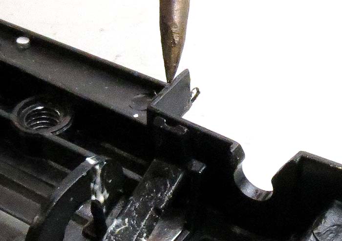

I use a homemade awl from an old flat tip. I ground it down to a fine point. It works great at popping them out.
Sorry for the bad photo, but I think you get the idea. A simple nail does the trick as well.

Thanks guys. I had a dental pick handy and that worked like a charm. I guess anything with a sharp point would work.
I had been taking the wrong approach and using flat-head screw-drivers. They got the magnets out alright, but also ensured that they could never again be put back in thanks to the broken piece of plastic. The sharp and pointy thing method seems to yield more desirable results. :)
