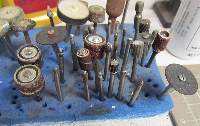

Postby HomeRacingWorld » Thu Jan 03, 2013 7:41 pm
Late, but here is most in my small arsenal.
Yes, I know...not very organized. But if I cleaned and organized, my buddy Tom wouldn't find anything and get mad.
I keep him happy.
