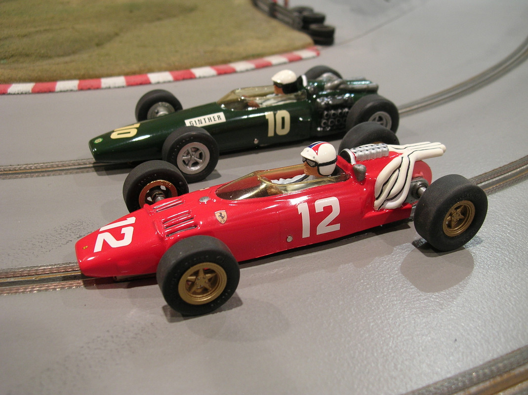

For the F1 class, I had some "Clear" Dubro bodies lying around, as well as some Atlas AT206 ball bearing motors (very quick little motors), some Atlas F1 chassis, and a bunch of Gorgeous Cox cast Magnesium wheels, soooo,.........I built a "Ginther" BRM and an "Amon" Ferrari for the series.
These "hybrids" were certainly in the spirit of the way we went racing back then, and both were more than competitive in the F1 class.........they are as quick as most of my current "plastic" cars on my home track.

Mr. Ginther chases Mr. Amon into the "squeeze" hairpin on my home track...........these cars still run great, and are right at home on medium sized club tracks!!
