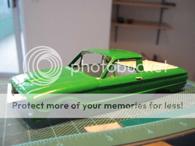

This is a timely post. Just got a loaner Ford Ranchero to create a mold from. I believe it's an AMT.
Brushed on paint's pretty thick. Think I'll try the 91% ispropyl dip to clean it up.

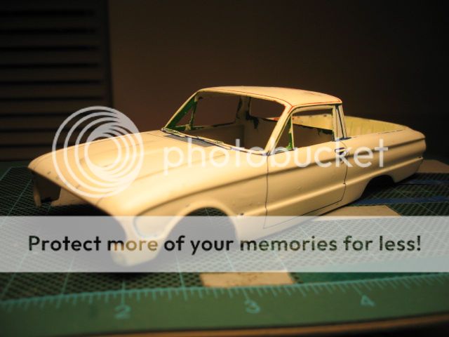

Ranchero cleaned of two layers of paint (green and blue/red underneath) after a 24 hour alcohol bath and a whole bunch of steel wool scrubbing and a bit of sanding stick.
Now some modeling to fill in the front and rear valences and cover the bed to prepare a slosh casting master. Re-pops will be available if decent.
Thanks for the alcohol bath confirmation.
