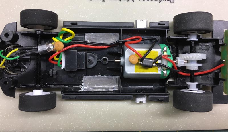

Postby davek » Mon Mar 06, 2017 3:57 pm
IT would not go through! davek :flags-waveusa:

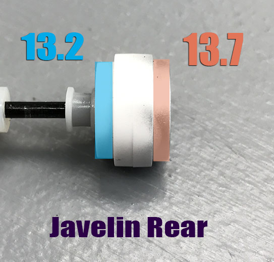

Postby redlynr » Mon Mar 06, 2017 4:40 pm
Well this is unfortunate.
The outer part of the rear rim is 13.7, the inner 13.2. This causes tires to fit poorly. For urethane users no biggie, but for silicone users, this a problem. Fronts are the same.
WTF Scalextric.

Postby HomeRacingWorld » Mon Mar 06, 2017 5:36 pm
That's more than unfortunate. Must clearly be some mold issues. I checked mine on the one side and seemed about even and the Quick Slicks tire I tested fit cleanly for me.
When I get home, it's going under the spyglass again.
Re: Scalextric Javelin - Review *FINISHED*
Postby HomeRacingWorld » Mon Mar 06, 2017 6:49 pm
Good catch. I rechecked the other side, and no doubt about it.
And since yours is that way, seems like a widespread issue.
I slipped on the QS 44 and it looked like a clean fit. BUT I can see just an angle.
When I put on PG tires, I just went straight to the Razor and trued them, so never noticed that slight angle.
Thanks for catching this, it's going into my review.

Postby Cheater » Mon Mar 06, 2017 8:36 pm
Just a suggestion for redlynr.Try building up the small side with pin striping tape.I've been doing this for year's.

Postby HomeRacingWorld » Tue Mar 07, 2017 10:01 am
Here is davek's chassis.
