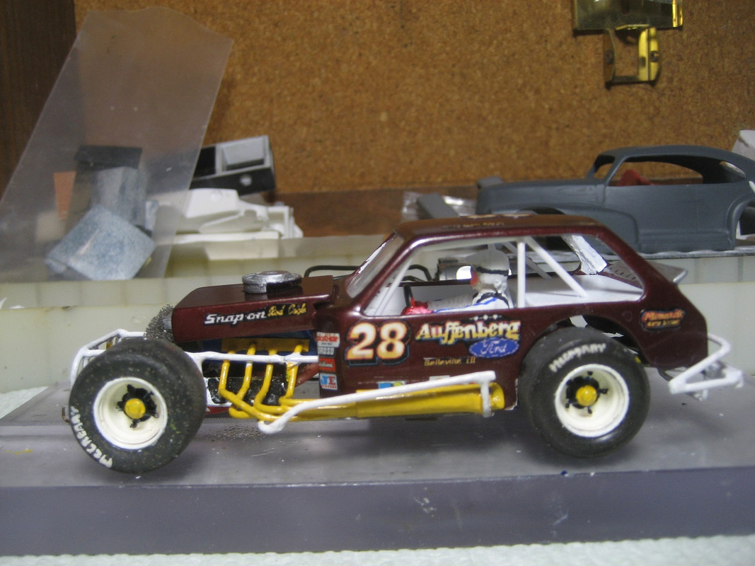

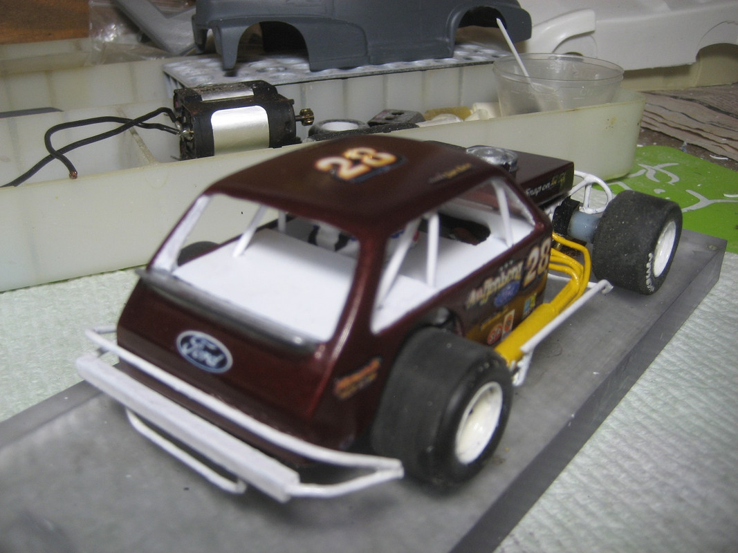

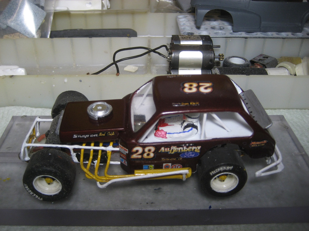

My tribute to "Dandy" Don klein's Ford Fiesta mod.
Ran all the dirt tracks here in Illinois/Missouri until he was in his 70's
Over 600 feature wins & I don't know how many track championships.
Just retired a couple years back & was running a dirt late model.
Never ran an engine that wasn't Ford.
Always a "Big Block" in the mods.
I re-purposed the chassis from a "Shootout" car from a while back.
It's a home-cast Ford Fiesta with Piranha motor, Parma gears, Pro-Track wheels with NY Modified inserts.
Brass 3/64 bass rod chassis, PG Urethanes & Dupli-Color paint.
Instead of decals, I ink-jet printed the livery on some adhesive backed vinyl that the General gave me to try
on my Labor Day visit. I get much brighter color than printing on label paper.
After printing a sheet, I covered with Scotch clear packing tape & cut with sharp scissors.
I shoulda' clear-coated it instead of furniture polish to smooth the edges of the "stickers",
but I like it anyway...............

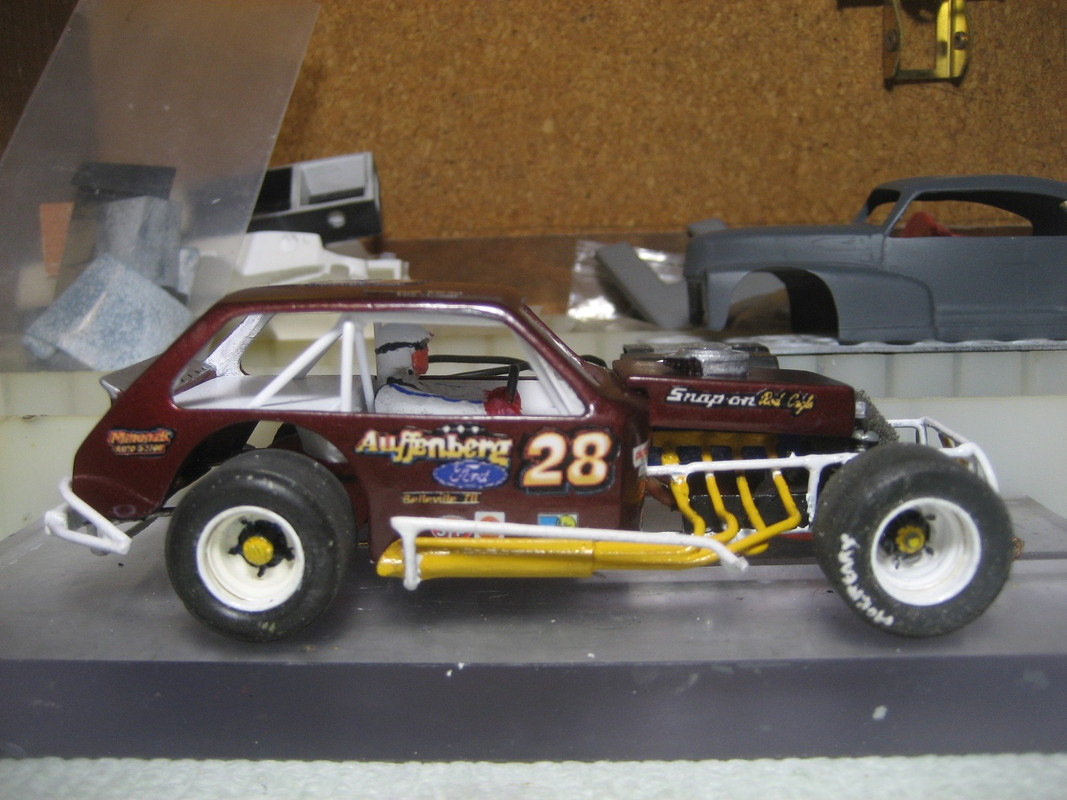

Postby strangebrew » Wed Sep 18, 2019 10:19 am
Didn't expect this thread to attract this much interest...so
I'll add a couple of previous replica builds from "back in the day"
Here's a couple Harry's familiar with form the 70's
I tried my hand behind the wheel for a couple of dismal seasons in this one.
Cigar chompin' Kenny Shrum with a 427 Chevy Camaro
A good buddy & one of my drivers from his ASA days runnin' with
Rusty Wallace, Mark Martin & Dick Trickle .
