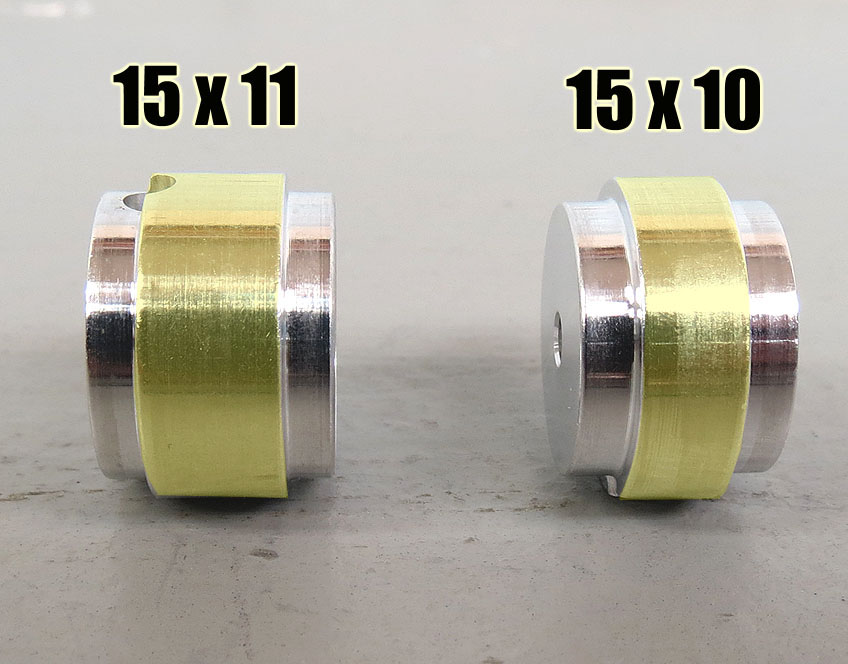

The difference between the CB Design 15×11 and 15×10 that affects the tire you choose is the center rib area.
As you can see the 15×11 has a wider rib than the 15×10
This applies to all styles of these sizes, Steelie, Insert, Racing, etc.

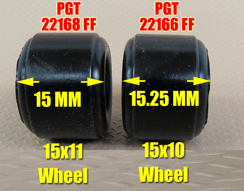

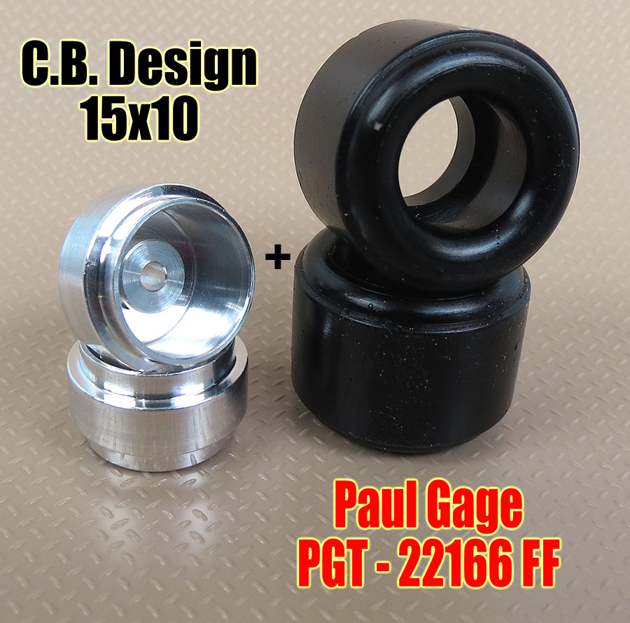

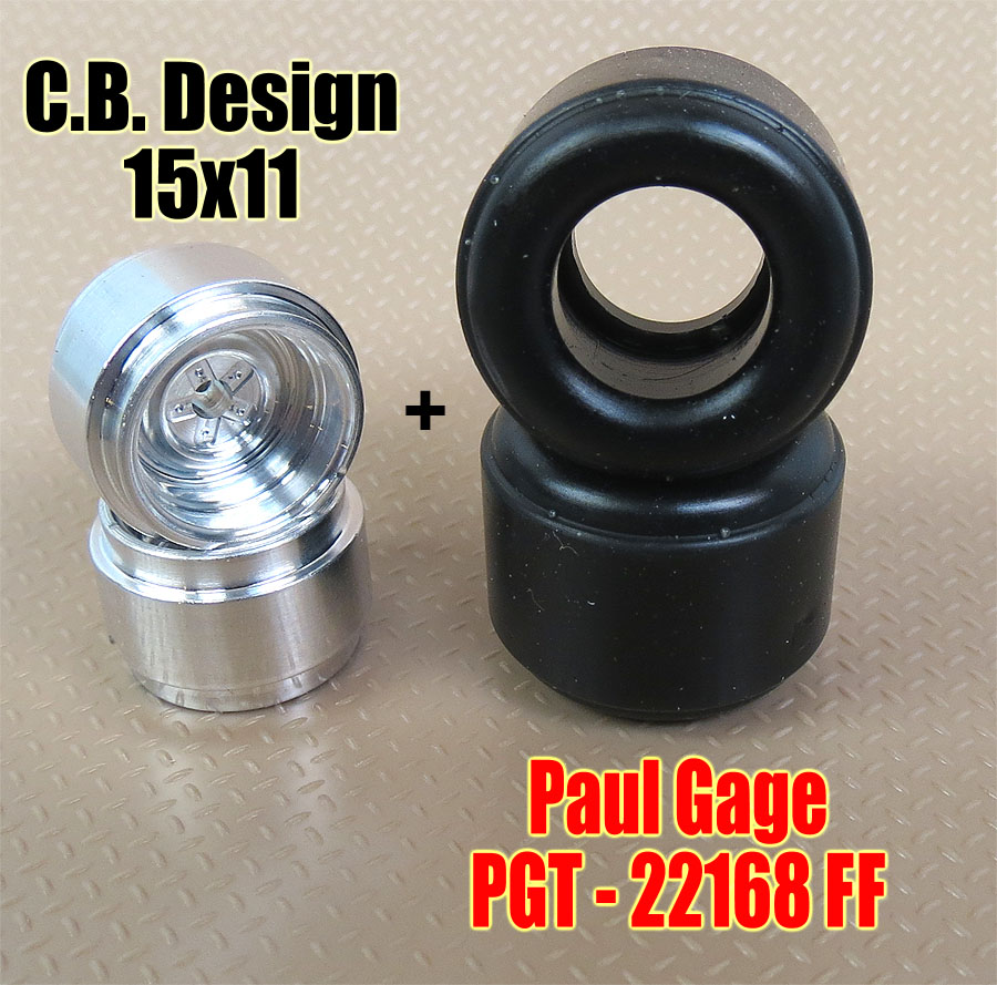

There are 2 sizes of tires designed for each wheel
Paul Gage 22166FF for 15×10
Paul Gage 22168FF for 15×11
The outside of the tires are the same size.
It is only the inside recessed area that is different.
