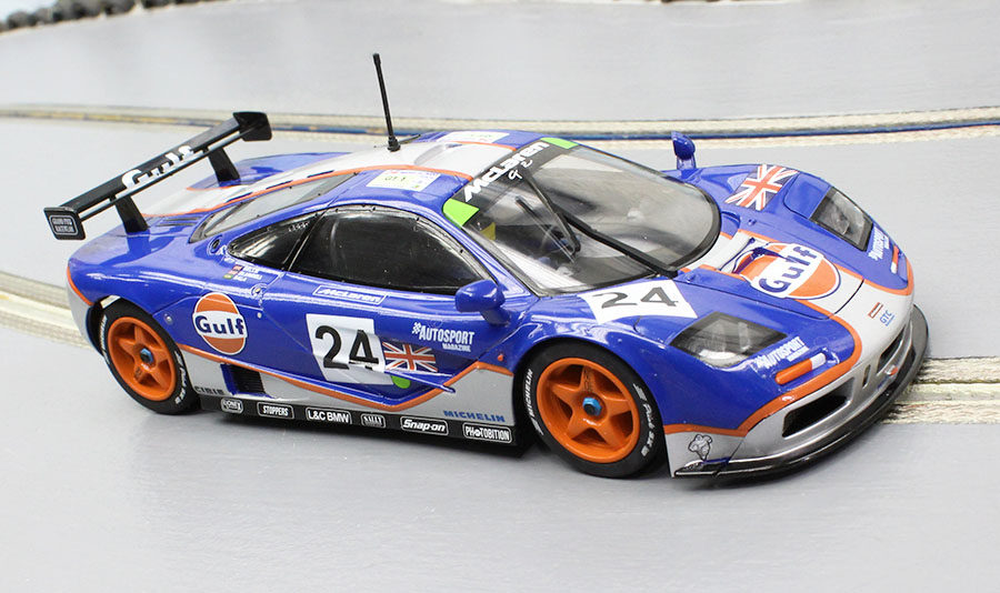

A famous McLaren from the 90’s returns to our hobby in 1/32nd scale thanks to Scalextric. They picked the perfect scheme for the introduction as well. Not many are as iconic as GULF adorned race cars, regardless of scale.

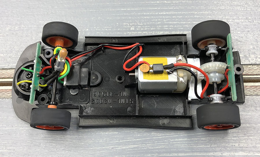

Body/Interior Weight: 22 grams
Chassis Weight: 48 grams
Weight Total: 70 grams (70.5 with body mount screws)
Motor:  Scalextric “Standard FC-130” Tested: 20,675 @ 12 VDC

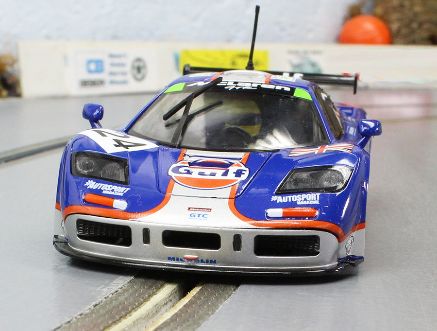

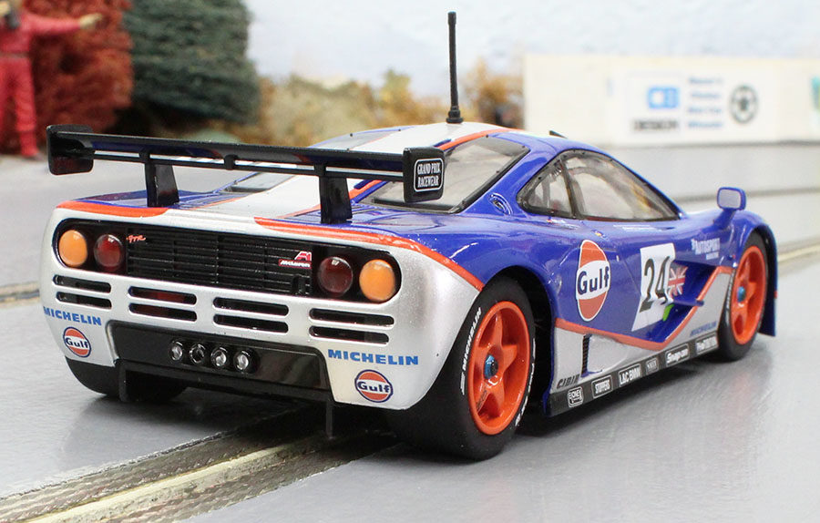

If you check the 1:1 dimensions as shown here, Scalextric has come very close. Nothing is perfect of course, but overall I felt the car represented the 1:1 very well.

The car is inline with standard 9/27 gearing. Bar magnet located just behind motor.
As the video shows, the car runs very well. This is on WOOD without the aid of the magnet. For that I have to give Scalextric credit where it is due.  To run this well on a surface it was not intended for isn’t that common with all ready to run models.
