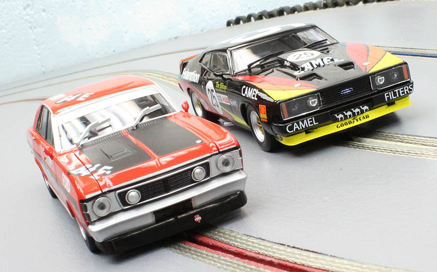

Two classic Australian Ford Falcons almost a decade apart. Each one a classic in it’s own right that highlight a legendary driver and an equally legendary race. If you are a slot racer in Australia, you should be pretty excited at the release of both.
I’m pretty excited and I am in the middle of the good old USA.

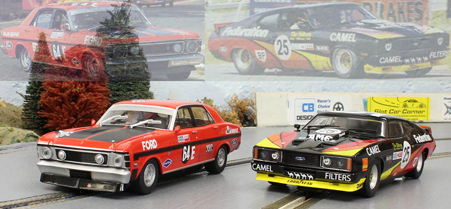

Now you might look at these cars and scratch your head. They don’t look like any Ford you remember. But if you sit back and research Ford in Australia, it will all make sense. Fascinating to me and you might find it creates a little more appeal for models such as this. To be very blunt, these models hold more interest than other various marques from Europe. Even with the steering wheel on the “wrong” side, they have very close ties with our own versions. Then you throw in the fast paced action that Bathurst featured and you get a win-win.

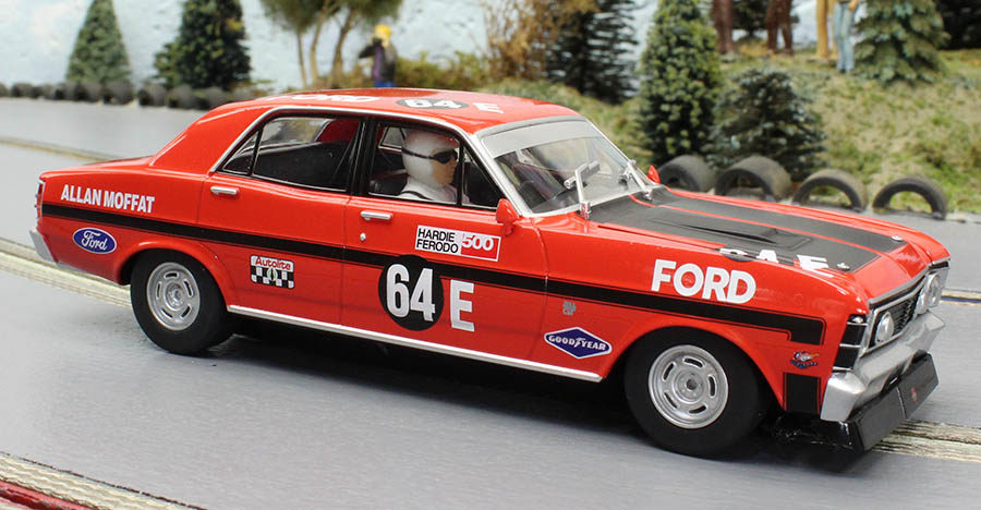

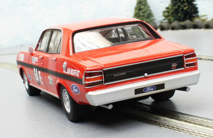

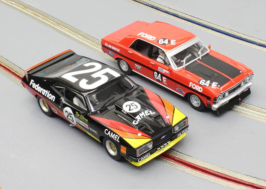

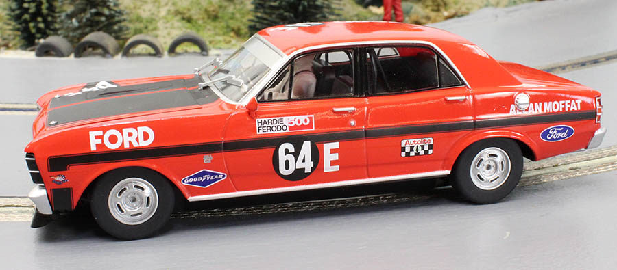

There is no explanation why I like the 1970 version. It’s a boxy little 4 door that most would rightfully laugh at on the street. But this one had the last laugh on the race track in 1970.
Taking the checkered flag at Bathurst in 1970
The markings and fit and finish are done very well. Nothing is ever perfect but it represents the prototype well enough for me.
Of course I am not an expert on the prototype. Just going on photos alone. YOU will make your own call as always.

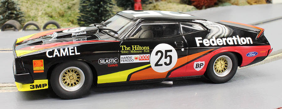

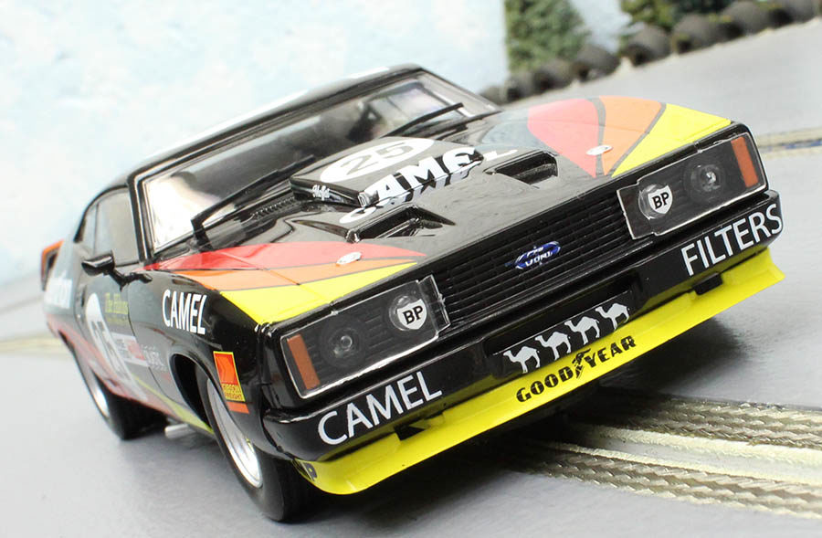

1979 version is a platform we have seen many times from Scalextric. Although this one has a different front grill and hood design, the inside is the same.
It’s the overall finish that stands out to me. I just reviewed a new car that costs almost $30.00 more from Spain that cannot match the opaque markings these cars have.

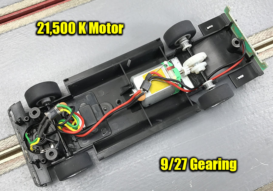

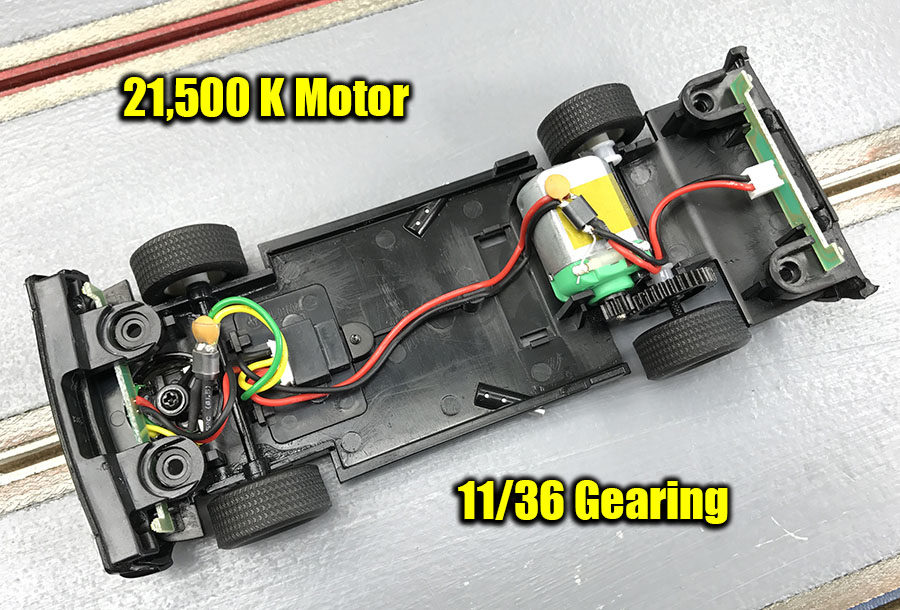

Inside we see the older 1979 Falcon with the same chassis it has had before. 11/36 gearing with standard motor in sidewinder configuration.
This model is lighted front & rear.
The new release has the inline configuration. Same motor but the rear wheels are slightly smaller. For the veterans out there, just relate to Slot.it 14×8.
As the video indicates, these rear bushings are very loose in the chassis. I used the same Hansen’s Hard As Nails polish to secure them. This holds them pretty well, and can still be snapped out without damaging the chassis.
