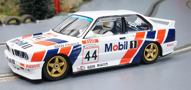

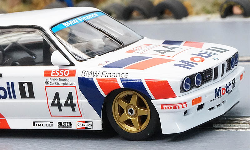

On the outside the car seems done well enough. Markings are clean and crisp and mimic the prototype well enough for my eyes.
The half tray interior Scalextric has returned to using looks well enough for me. Not everyone is in agreement with this of course, but for my eyes it works just fine.
The only thing I see that stands out is the wheel pattern choice. In researching this particular model, it appears these wheels are incorrect. The prototype photos I found here had 7 spoke Technomagnesio wheels and not the more common 5 spoke Dymag type wheels the model come with.
Is this a big deal? Perhaps not. It could be my research is flawed. It does not take away from the appearance as many cars in the series used this wheel design. Then again it might matter to some scale enthusiasts if my research is correct.

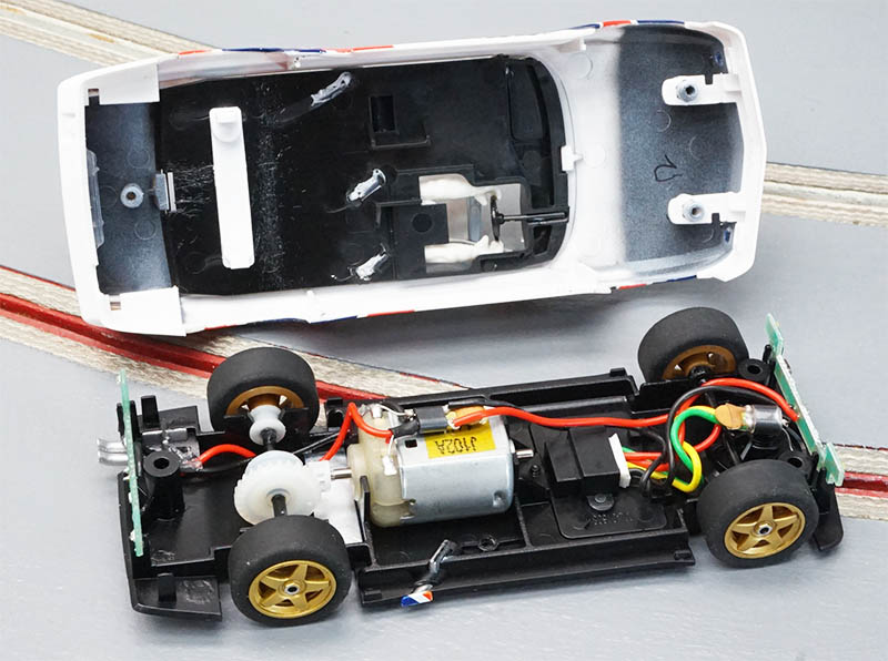

Looking underneath we see the inline chassis which is another subject for debate. Some like it, some do not. I do like inline so the model suits me fine.
Removing the 3 screws we get a close look inside. Stock motor is present and gearing is the industry standard of 9/27. Large bar magnet in place as expected and my favorite part: Lights. Both front and rear. No actual braking lights but that doesn’t bother me.
One thing I noticed during my first laps out of the box was a very distinct rattle sound. I thought perhaps interior but under closer inspection it was the motor. It isn’t a very tight fit in this car and movement is noticeable front to back.
The video above shows how I fixed it. It also addresses the wires going to the rear light board. They were wedged under the crown gear and rubbing. That certainly isn’t good so I moved them safely out-of-the-way and glued them.
