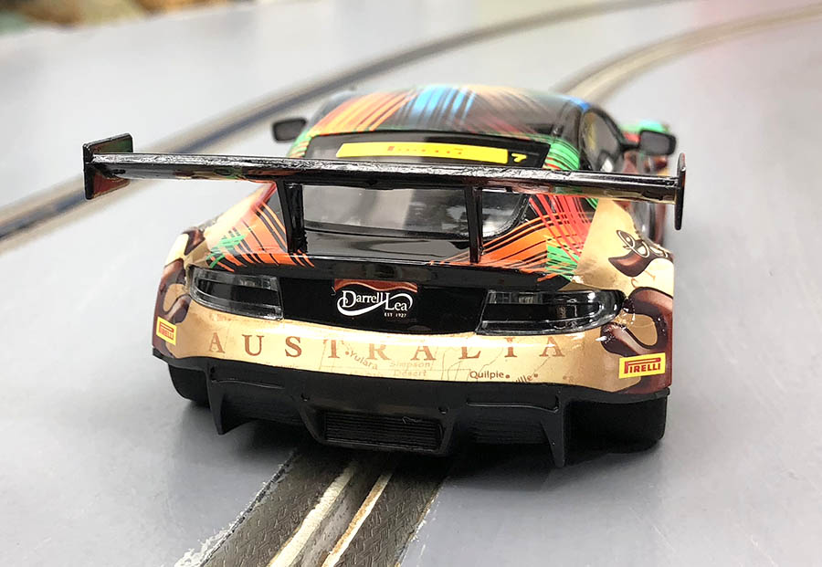

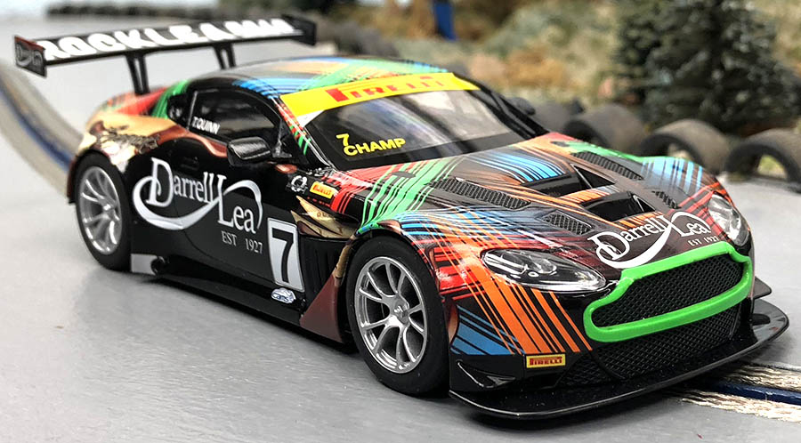

On the outside the car is well done and is a very close match to the prototype. These are not tampo stamped markings, this a decal type method that Scalextric calls “water labeling” and it does the job. Especially on models that the designs would be extremely difficult, if not impossible to accomplish with traditional Tampo stamping.
The outside looks fine for my hobby dollar. It is one wild scheme to produce and any fans of the 1:1 car should be pleased. Nothing is ever perfect, so only you can decide. For me? Yeah, I like it and it will be raced.
That wing is a big one and not surprisingly it won’t take a lot of hard knocks before breaking. But that is just the chance you take in or hobby when we want scale appearance. Hopefully it can last a while even in my hands!

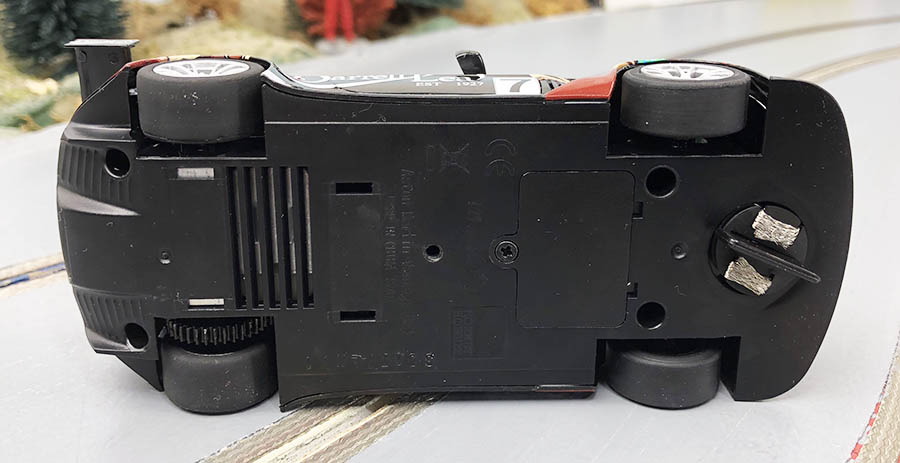

As we mentioned, it is still the sidewinder configuration with standard bar magnet behind the motor. Digital plug and play for the Scalextric system and solid front axle configuration. And additional/alternative magnet pocket is seen in front of the motor.
Standard gear ratio here. There is a bit of side to side freeplay in the rear axle. And some freeplay in the bushing to axle fit. But very common on all these models. Not a deal breaker for myself or the tuners I race with.

Removing the front axle/wheels:
You will need to remove the tires and then using some elbow grease, you will have to twist and pull. Usually one side will break free and you can then remove the axle from the chassis. YES, that means the knurling on the axle will grind away some of the plastic inside the wheel hub. YES, it’s possible you can crack that hub. Yet these are the FRONTS. I have glued broken fronts back on and they are still there, and quite true, many years later. Is it worth the risk? YOU can answer that.
Now that the front are installed, we can move to the rear.
My first modification was a tire change. Since the rest of my small fleet of GT cars are Paul Gage, I stuck with them.
Nothing complicated here, just a simple wheel and tire truing session. I started with 600 grit and finished with 2000. Very smooth and clean finish and ready to install into the model.
So as you see, I am very pleased with the car overall. Yes, you can perform more performance modifications. This was just a simple, low cost approach.
Lap times were on par with my “test mule” Mercedes AMG GT3. 3.85 was the average for the Mercedes and 3.88 for the Aston Martin. Basically all driver here and that is how I like it.
No complaints from me on this one. Looks good, runs good, fair price. An easy choice for modern GT fans.
