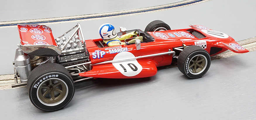

If you are new to our hobby then allow me to welcome you to one of the most interesting series of slot cars we have to offer. The brand Policar is a longtime household name in Europe and the brand was recently revived just a couple years ago. The big attraction to the brand is this series of classic Grand Prix models due to the attention to scale detail and the precision one of a kind running gear employed inside.
The term “Eye Candy” is often used with these models and rightfully so. Given the design must allow us to race and adjust it, the detail level they are able to accomplish is impressive to me. Some do not care for the driver helmet/head but it doesn’t bother me. At SPEED where it belongs, they look just fine.
Markings and finish are good as it gets in our hobby.
Not many may know much about this car, but over here there is no ignoring the STP that adorns it. This is a very striking paint scheme that is going to catch the eye of many of you.

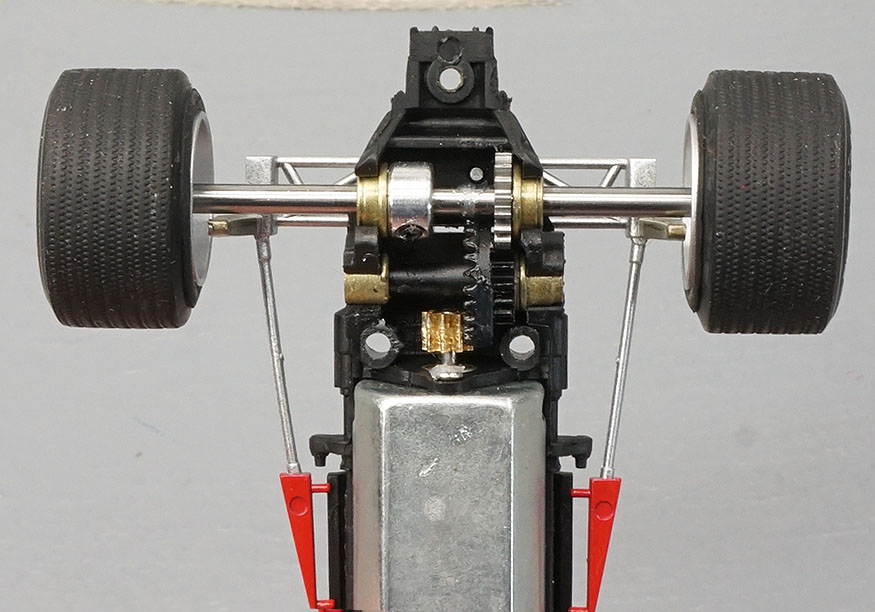

Mechanically speaking this model is basically the same as the Lotus before it. That means taking it apart is a very delicate process and you should be aware of that before you start. My advice? If you don’t need to open it…don’t.
Removing the front screw and the 3 small brass screws in the rear allow you to gently remove the body.
Inside we see a now familiar sight. Standard Policar motor and the gearbox system.
*NOTE* This model is NON-MAGNET with no traction magnet
For an in depth look at these, CLICK HERE for the Policar PDF file. It’s for the Lotus, but starting on page 5 it describes this system which is the same.
9 tooth pinion installed on the motor drives the gearbox.
Motor is 25,500 @ 12 VDC. I have tested a fair number of them and this is the common average. The motor is a little too hot for my taste, but for most it seems to be just right.

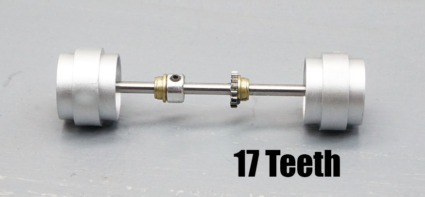

Aftermarket tires are readily available.
Tire sizes same as Lotus.
