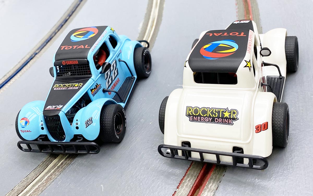

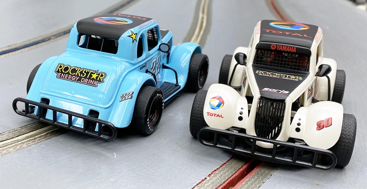

So I do think they are well done on the outside. Very eye appealing and capture the Legends very well.

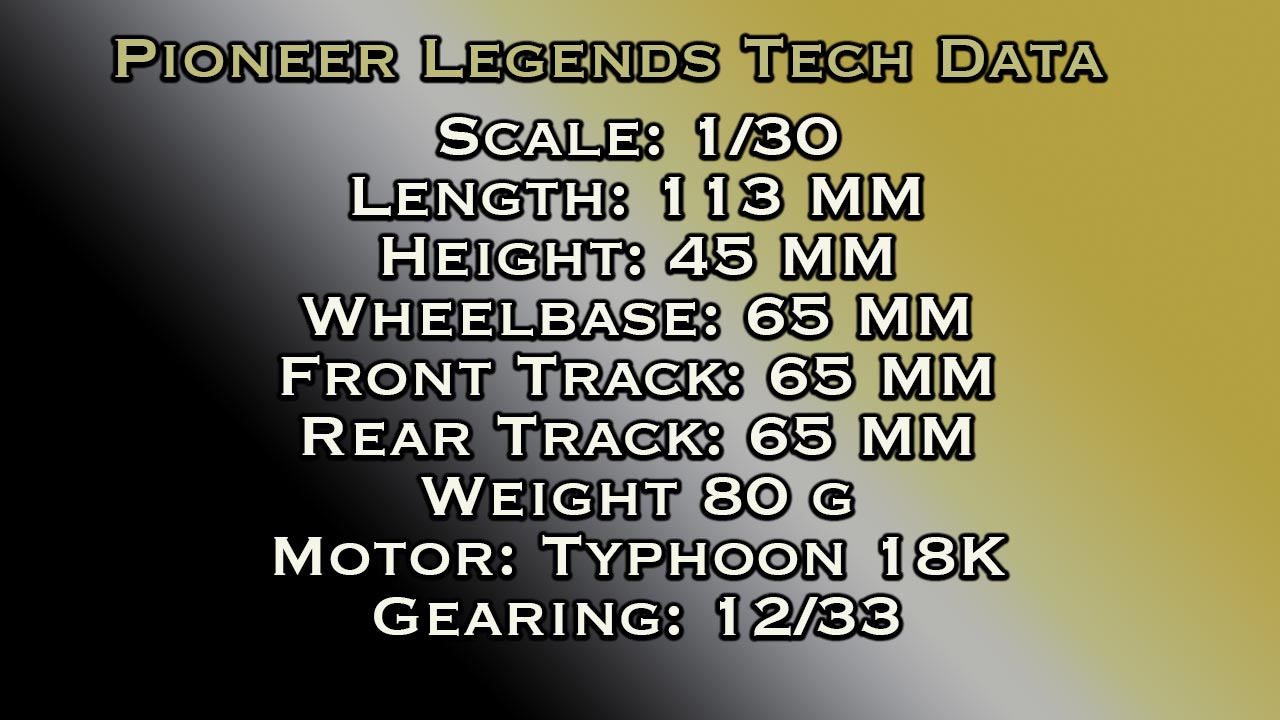

The size of the models is meaningless to me. They fit on 1/32 track nicely. Those that are so particular on scale and classes? Well, if you are…then what else would you run them against? So, they will run together as designed. For me, utilizing the common standard wheels, axles, gearing sizes was more important than scale/size. It was a smart move.

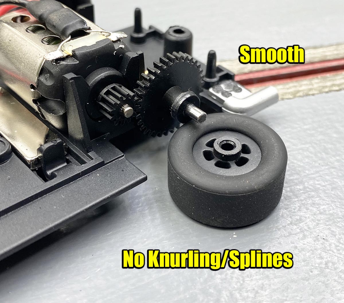

As mentioned in the video, there are some things I just don’t care for. Among the guide being so loose, (which it is quite bad) the bushing to axle fit is equally bad. On most of our ready to run models, the bushings have a slightly larger inside diameter due to the knurling of the axle ends. The larger diameter allows them to be slipped over the axle.
But the axles here are smooth and no real reason for it. The knurling for the spur gear would not prevent the use of a more precise bushing. A shame really. It causes bad vibration and chatter for us non-magnet users. We deal with this on lower cost, mass produced models, but I expected more from Pioneer. Especially given all the years they had to create it.
