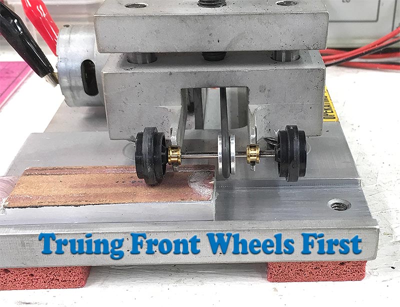

fronts
After removing the chassis, my first step was the front axle. Using the Tire Razor I trued the wheels first and then installed the tires.
