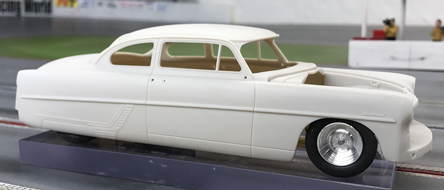

Moebius models makes several kits I could choose from in 1/25th scale. Instead of going with the standard 1953 version, I chose the 1954 Club Coupe.

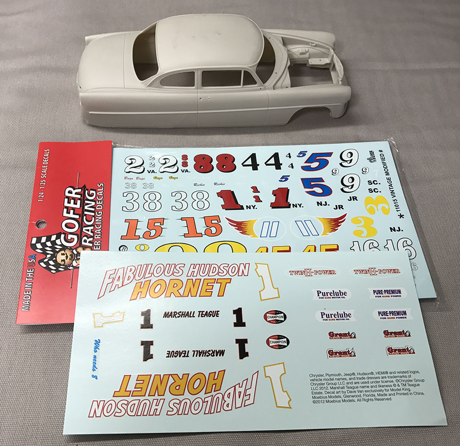

I decided to make my first Hudson a pure fantasy scheme. The decals behind the Moebius sheet are from Gofer Racing. They created very high quality decals that are basically the kind you see in your kits. I purchased two of these sheets in order to have more numbers for the builds I create. Even with a double order, the value is there. Quite a few models can be made with these sheets. It’s also worth mentioning that the size of the decals will work with many 1/32nd builds.

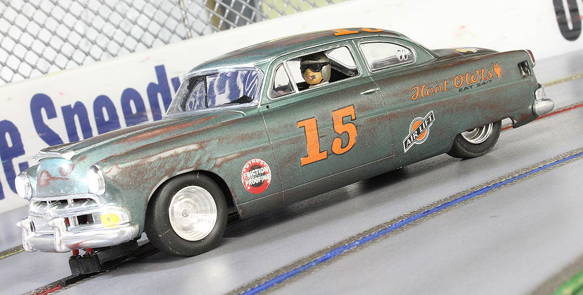

The scheme I chose was based on a photo I discovered. I rather like the weather worn look and decided to give it a try.

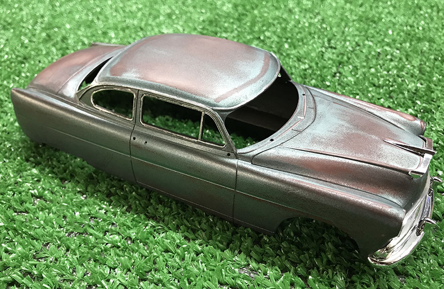

The process of this “patina” look is quite easy. I prepped the body as usual and then sprayed 3 coats of Rust Oleum red primer. I wet sanded the primer with 2000 grit and then laid on the top coat.
Top coat is Dupli-Color Hampsted Green Metallic #BHA 0906 I get from my local Auto Zone.
After drying I used 1000 to 1500 grit to sand through the top color coat until the primer coat began to expose. No real science here, I just sanded until the look I wanted appeared.

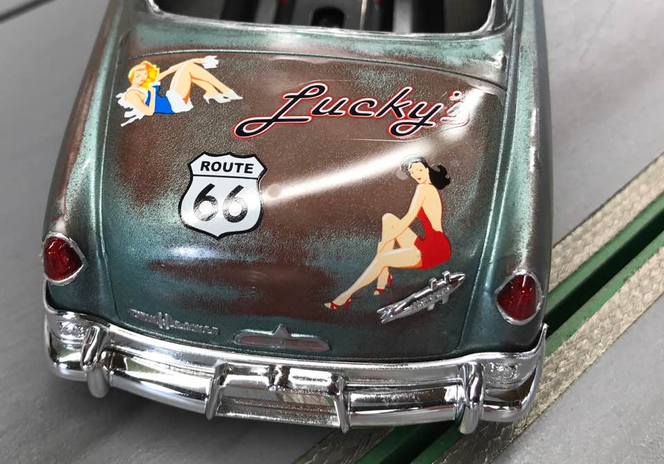

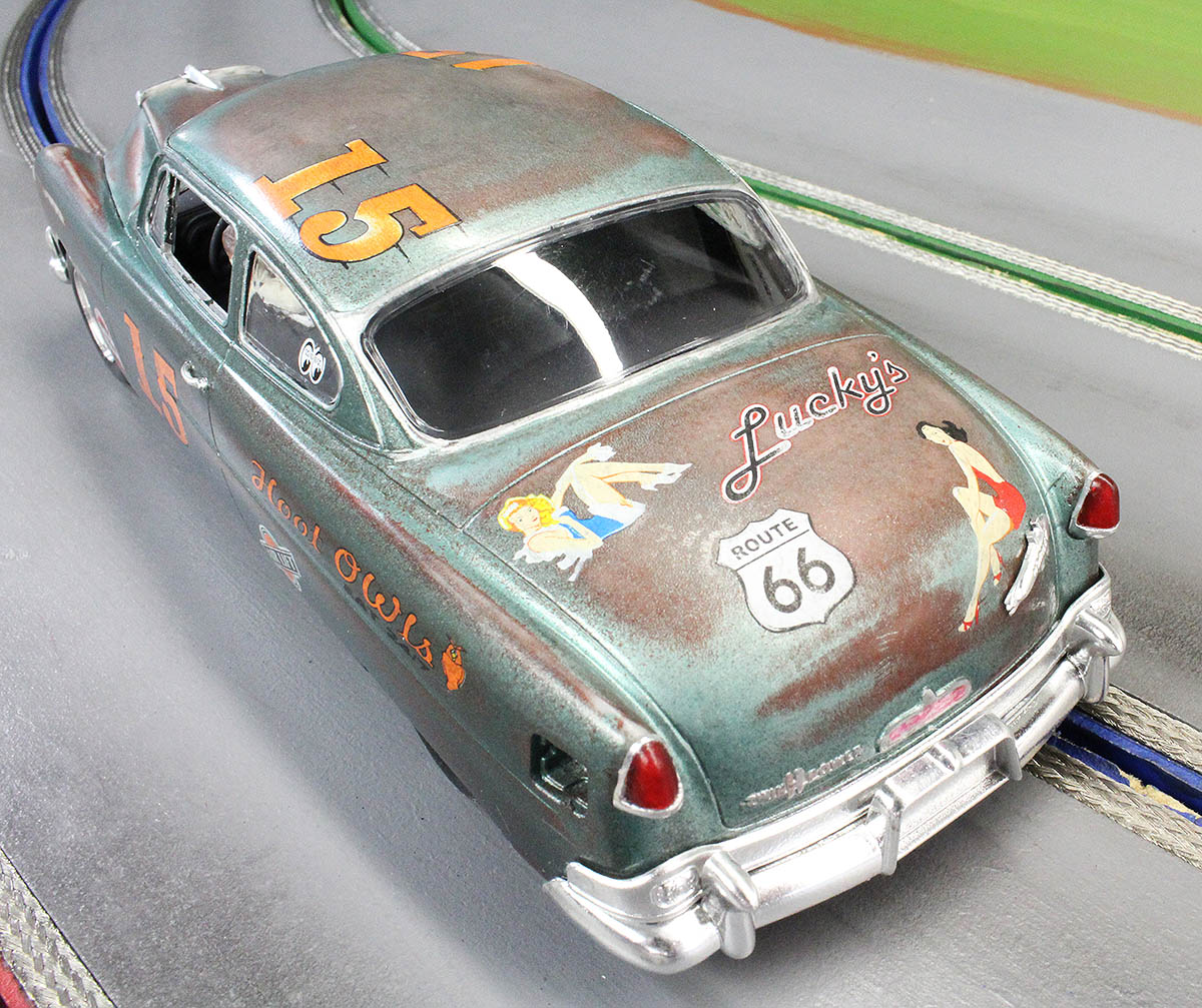

I could make out some artwork of a woman on back. I looked at my decals and didn’t have anything close enough, so I improvised. GOFER Racing decals were chosen again. They make 1/24 nose art graphics for the WWII era aircraft and I thought they would do the job.
For the small amount of chrome trim I used the now famous MOLOTOW liquid chrome pen. I just can’t say enough about the finish this gives you. VERY shiny and well worth price of admission.

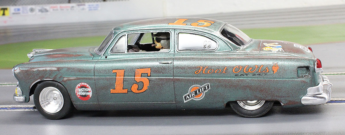

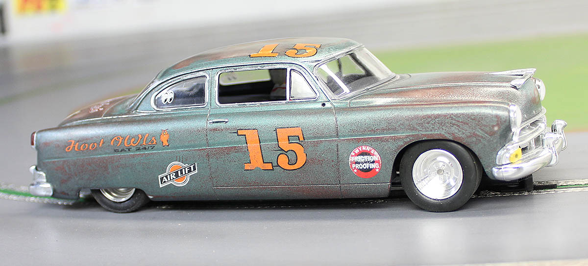

The final coat to dull things off is the cheapest floor “shine” you can find. I use the Dollar Tree “Totally Awesome” Mop and Shine. Using a simply Testors paint brush, I coated it twice.
So to be clear (ahem) there is no SHINE to this product. It drys to an awesome dull finish, regardless how many coats to apply.

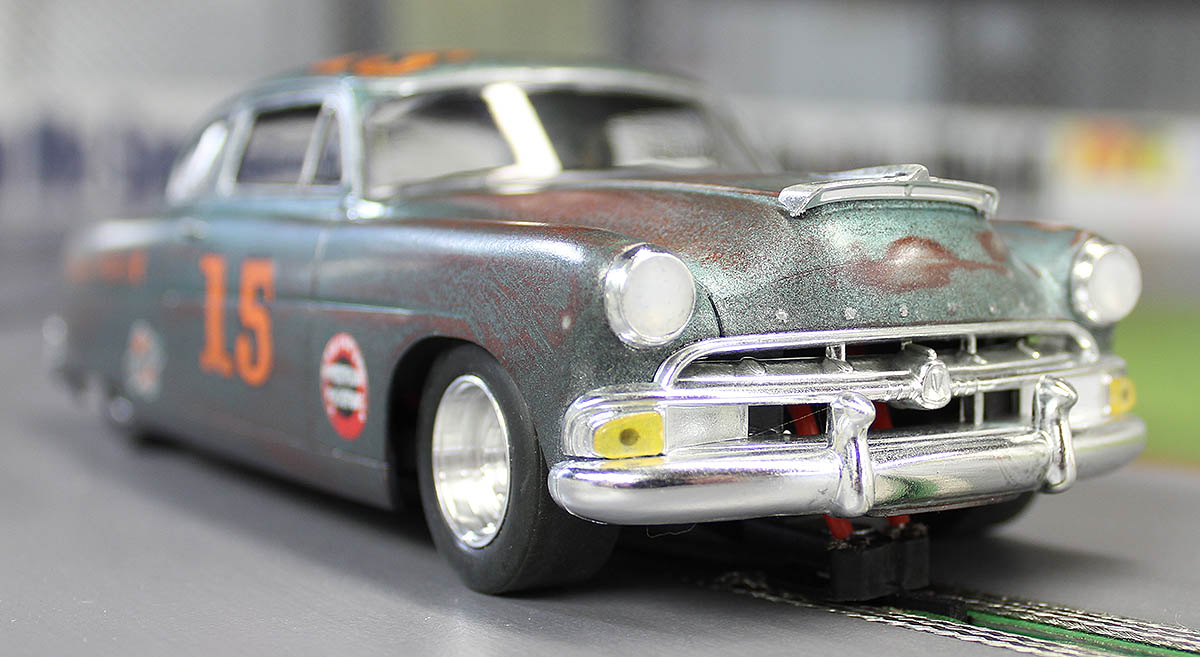

All finished. I am by NO stretch an award-winning model builder. My goal is to create something that looks the part well enough and this project seemed to accomplish that. This is a slot car after all and at speed on the track, it looks good enough for me.
