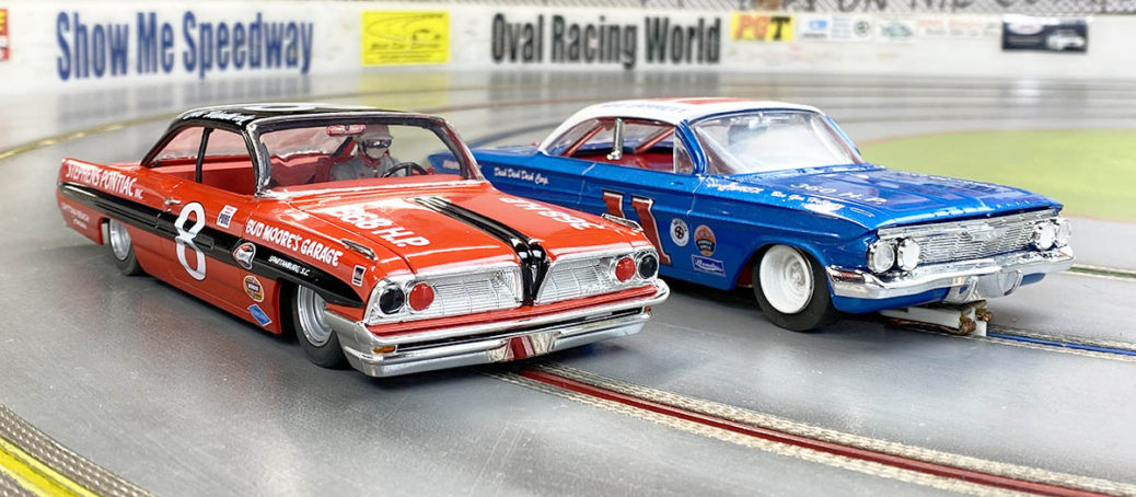

This series covers a small time frame in NASCAR history. We are modeling what we jokingly refer to as “land barges”. Those late 59 to 64 cars that were long, lumbersome, and likely the worst candidates to make a race car with!
But they did it. And some of them did it very well. Watching video of these beasts in action is nothing short of a hoot.

Time period: 1959 to 1964
Any American sedan 1/25th or 1/24th plastic model kit body that they used in the series.
No El Caminos, Rancheros, or Trucks.
I will suggest 1/25th. There is a difference albeit slight in some cases.
NO short box models. That means no Mustangs/Camaros, etc.
We are talking about those large and long sedans here. We will give you examples.
If the trunk is longer than the hood, you likely have the right model to start 🙂
If you find a kit, simply ASK ME and I will make the call.
NO resin or clear lexan bodies. Standard model kit bodies only.
