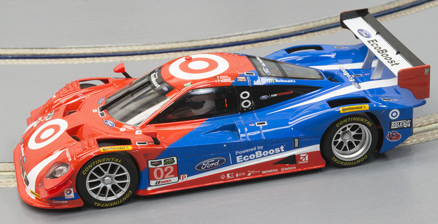

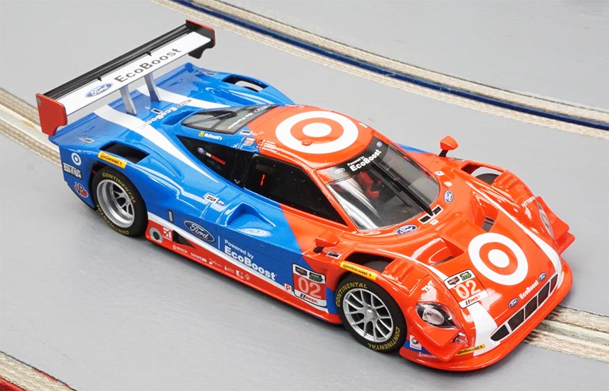

This car represents the “Gen3” series of DP cars and the last of the series as we know it. As it is Scalextric did a fair job in 1/32nd scale. Nothing is ever perfect of course, but a clean and acceptable job all around for my eyes.
Quick Data
Height – 34 MM (36 MM @ Rear Wing)
Length – 145.5 MM
Width – 61.75 MM
Wheel Base – 87 MM
Weight – 74.8 Grams

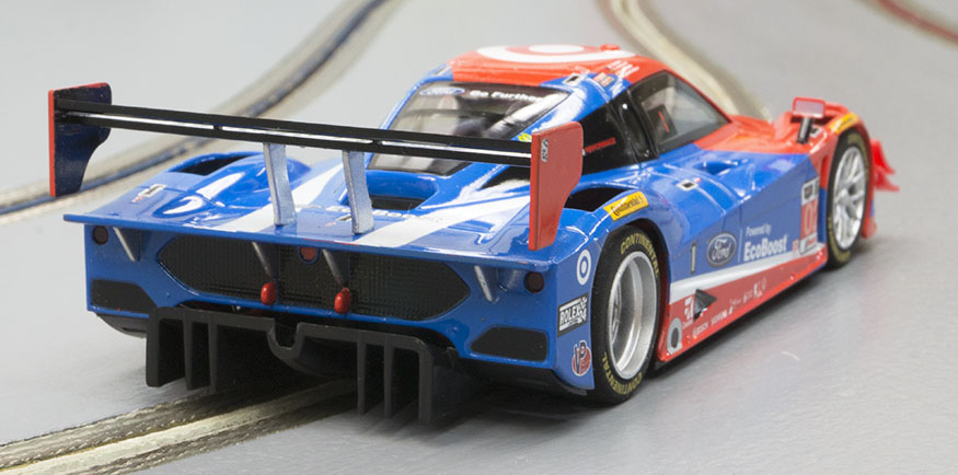

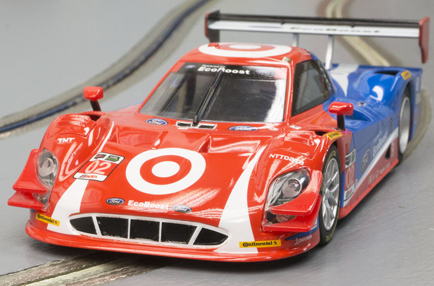

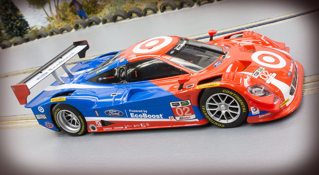

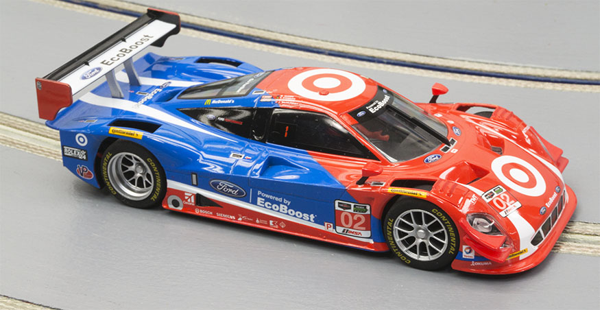

The cockpit or greenhouse of the car seems a little low to my eye. It appears to be that the front windscreen area is just angled too much and causes it to look slightly short in the center. I am not an expert on this series by a long shot, but comparing prototype photos seems to reflect that to me. The air ducts for the brakes are also missing. These were added after the original design of the car, so I can see how they were passed on. It takes quite awhile to tool up a new mold and impossible to keep up with body changes as they happen.
The decals/markings are again very crisp and clean. I noticed a little orange peel effect in a few small areas, but nothing to spoil the fun factor.

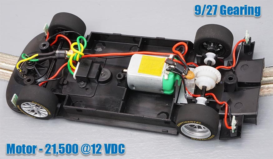

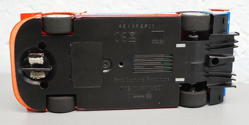

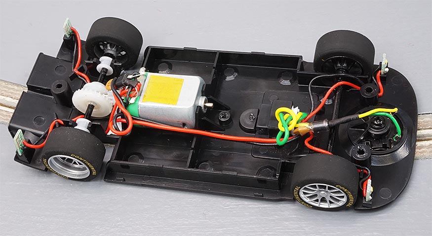

We see the now standard inline chassis with 3 mounting points. This chassis is easy to attain float by loosening these screws.

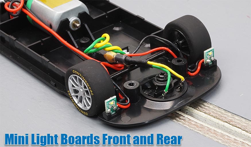

This car is lighted front and rear and I like these smaller light boards.
Simple and efficient in my view. 9/27 gearing with standard motor.

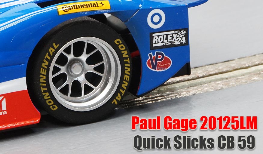

Tires will be easy to get with the new wheel sizes. It matches a Slot.it 17×10 for those looking for other brands.
