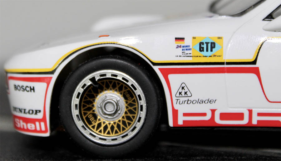

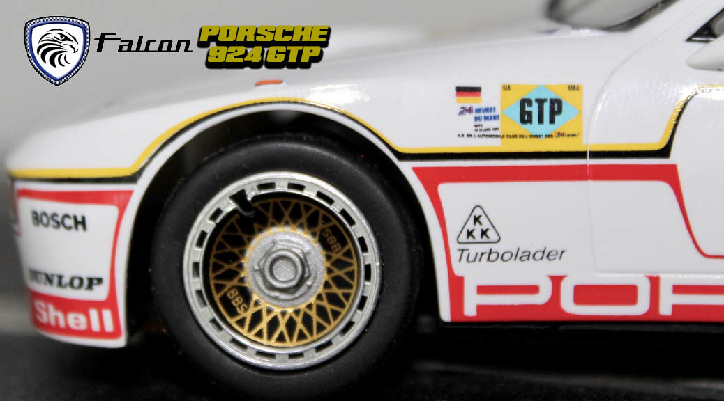

This is a very nice looking car, one slight blemish behind the driver’s side rear fender. That’s it and hardly noticeable.
The body is very tight to the chassis, so folks that like the body float will have some filing to do.

Rims and tires needed very little in the way of truing, slight sanding of all four rims and tires took less than 5 minutes. The stock magnet in the car is strong, on the Magnet Marshall it weighed in at 129g. total weight. The car itself weighs 70 g.
