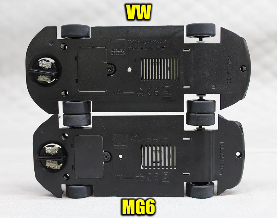

The cars on the outside are well done and the appear to have some very similar traits. I decided to take a few measurements to see just how closely they match up on paper.
Out of the box these cars ran just fine on our wood track. They are not made for our kind of track, but they showed potential. Since I have tuned the two previous models to suit my taste, I just took these models straight to the bench to get started.
| Model | Wheelbase | Weight | Width | Length | Height | Motor RPM |
| VW | 85mm | 80g | 60mm | 153.50mm | 43mm | 21,500 @ 12VDC |
| MG | 85mm | 82g | 59mm | 146mm | 42mm | 21,500 @ 12 VDC |
***With lead added 90g for each model***
As you can see, they are very close.
Each model is inline with standard 9/27 gearing.
