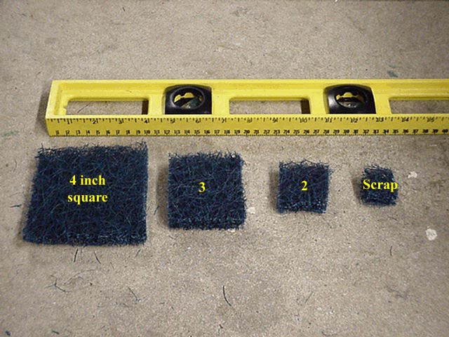

 Then it was time to cut the furnace filter.  I made strips 4 inches wide, 3, 2 and finally the smaller scraps were left to “top” it all off.
Using 2 of each size, place them on the rod and push it on through to where to want on it on the trunk staggering the squares as shown.

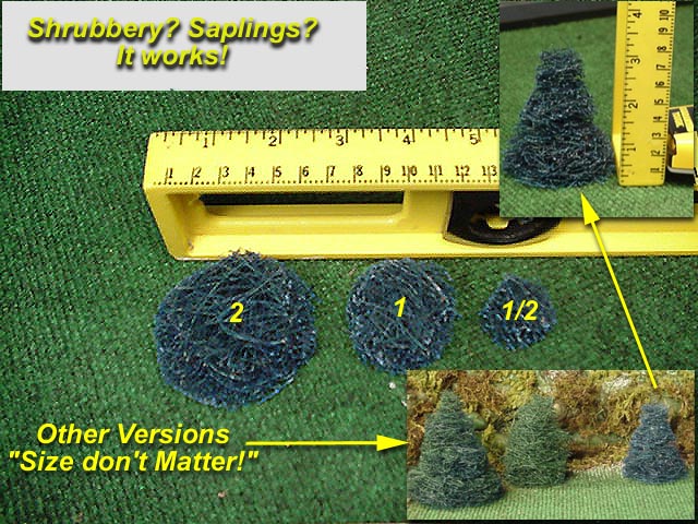

Then take a scissors and trim the corners from the squares, plus using your scissors at an angle adds more to the effect.  You are just about finished, not too hard is it?

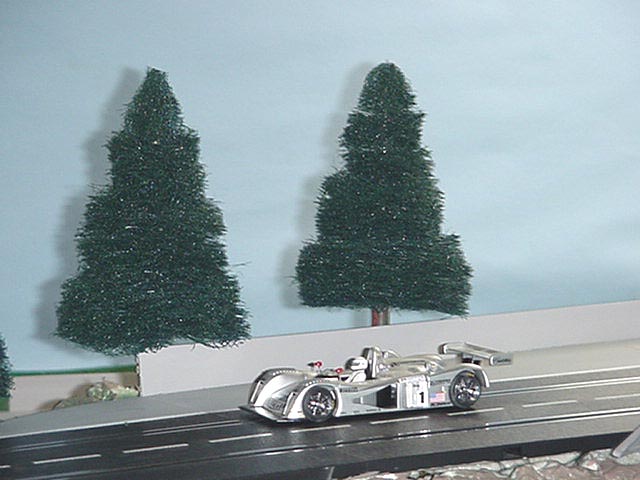

Once all this is completed, form the filter material with your hands until you have a shape you like.  Now comes the simple final touch of spraying the tree with a good coat of green paint.  And that’s it.  You are finished, and you have a very nice tree that gives a lot of life to your layout, and you did it in one afternoon.  These trees are pretty tough and will stand up to the hardest of crashes, and there is no ground foam or small debris to fall off and get into your track or picked up by your cars, and they are friendly to the bodies of your models as well.
Inexpensive, durable and a good combination of realism and what I like to call “raceability”.  Don’t wait until spring to get these planted on your layout.
