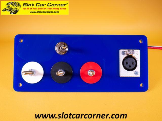

Since the inception of Slot Car Corner in 2006, we have offered a wide selection of slot car tracking wiring products and services including custom Driver Station fabrication and high-quality Driver Station Kits. During this time, we have fabricated close to 1,000 driver stations for our customers worldwide. This article features our “XLR and 3-Post Hookups With Lane Reversing Switch” Driver Station Kit (SCC part number DS0320) shown below.
The driver station featured in this how-to article has a blue panel; however, kits with red, white, yellow, green, orange, purple and black are also available.  This driver station is designed for controllers with male inline XLR connectors  or alligator clips and features a toggle switch that lets you run your track in both directions. Note this driver station, when wired as recommended, is polarity independent – it will work with both resistor and electronic controllers.
