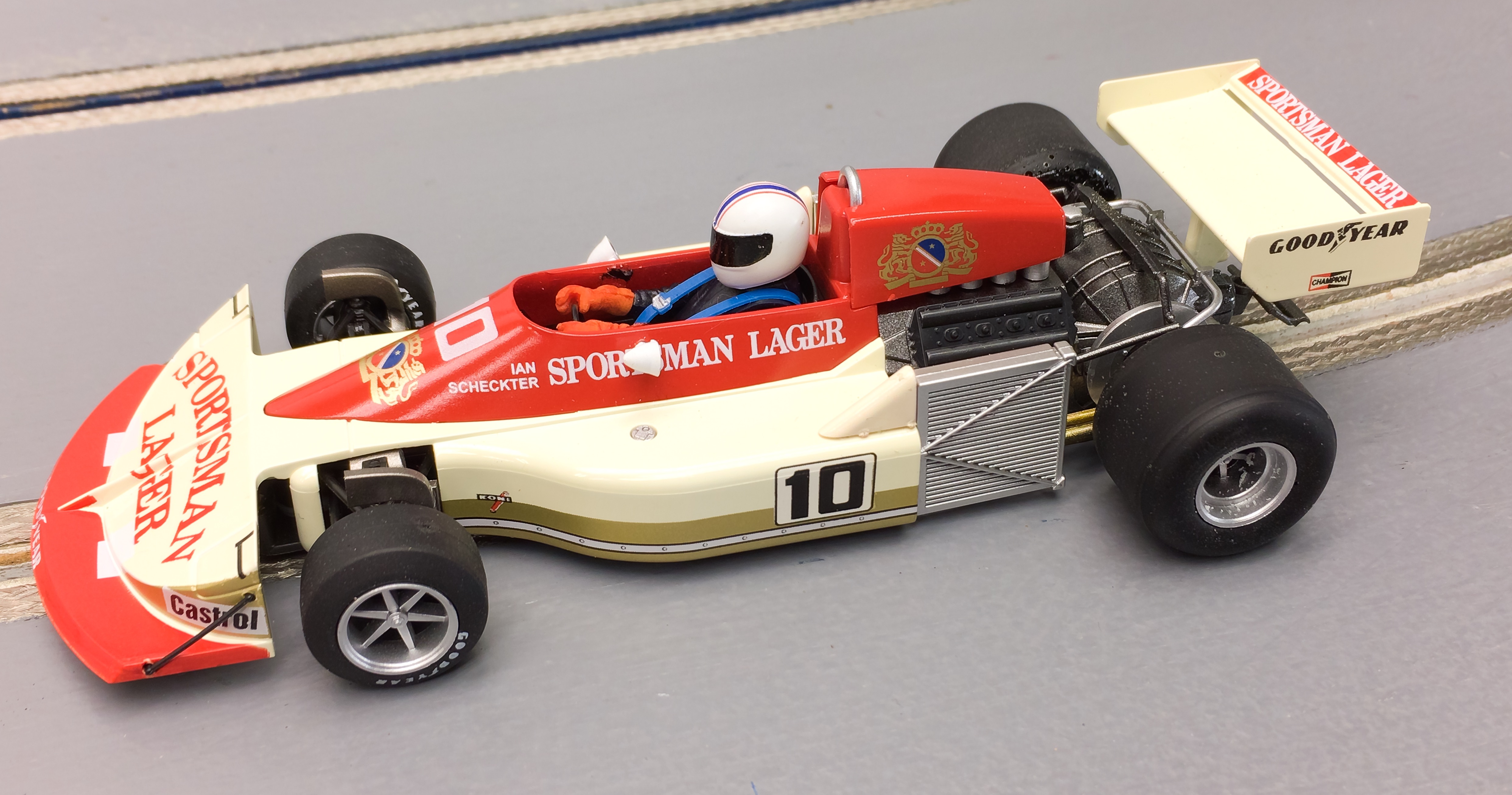

Good old Fly. Our so-called love/hate relationship with them goes back many years. Some cars were stars, some never shined. This model is one of those that have always been a favorite of mine and as you can see, still gets plenty of attention.
img_1157
The classic F1 series is a hit and miss series from them. Models like this March, recent Brabham and Lotus 78 which uses the traditional (and much preferred) inline configuration are the ones I feel are worth the tuning effort. Other releases such as the Williams are almost useless due to the drivetrain and inability to even secure replacement parts.

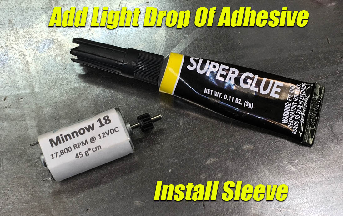

You can use a sleeve on the end of the motor shaft to allow the shaft to set in the crown gear as it should. The gear is set for a 2mm shaft and without the sleeve, the entire rear axle can have excess side to side freeplay. Slot Car Corner carries sleeve material here. I secure the sleeve with Super Glue.
I use a mini miter saw for cutting the tubing. Just a few quick passes and it’s through. Clean up any flash with small file.

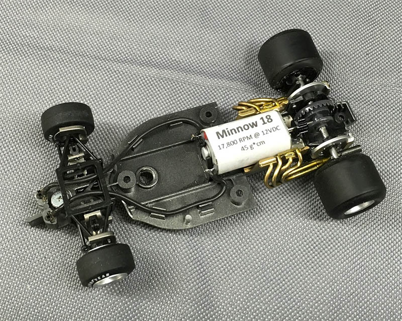

The finished chassis.
For our track these changes create a great running slot car. Flyslot still has some nice cars that are worth investing in, and these are near the top of the list for me.
