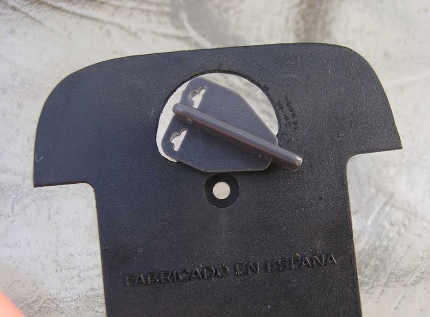

The first picture is of a stock Fly chassis/Guide, with the guide rotated as far as it can go. When racing, (especially without magnets) it is easy to make the car slide more than the stock chassis design permits. When this happens the guide is slammed against the chassis and you get a “tank slapper”. This can lead to either the guide blade or the chassis itself breaking.
fy1
STOCK CHASSIS/GUIDE
fy2
The next picture is a top view of the first picture. Here you can see where the guide butts up against the chassis, preventing it from rotating further.

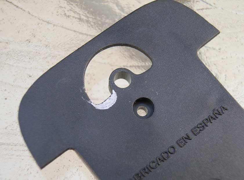

The fix is simple. I have highlighted with a silver sharpie the area of the chassis to be removed.
I normally use a round burr in a Dremel but, a round file or even an Xacto BLADE (if you are careful) can be used.
fy4
The photo above  shows the modification made to the left hand (as you are looking at it) side of the chassis.

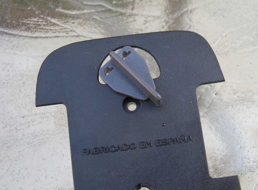

fy5
For this Demo I have used the stock guide, and in the last picture you can see that the guide is now able to rotate considerably more than stock.
For those concerned that removing plastic will weaken the chassis…rest easy…..now that the guide can rotate nearly 90 degrees, you eliminate the potential of the guide hammering on the chassis/guide post, and chassis breaks in this area are a thing of the past.
