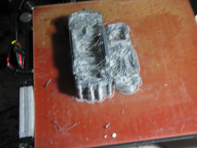

As you know, I got tired of cleaning my prints so I got a new print a couple of weeks ago with the dual head extruder. Its a Lulzbot TAZ 6 and so far it has been a nightmare to get it to print without pulling up what it had laid down. It has the auto adjustment like my Mini has. Biggest issue is that it didn't print correctly right out of the box and having to make changes to the firmware and software. I'm used to just printing out the standard way. Anyway, after 12 hours of printing last night I got the following hairy monster:

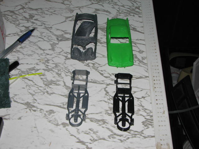

Then after thirty minutes in warm tap water, I got the following:
With the grey parts being done on the new printer and the other parts done on the mini. I liked how the chassis turned out after an extremely easy cleaning but I was really displeased with how the body turned out. So, I jumped back into my little think tank and talked myself into flipping the body position over, changing the layer height for the grey filament to 0.25mm from the 0.23mm and upped the wall thickness to 1.25mm from the 1.0. So I'll wait for another eight hours while a new body prints out and see how it turns out.

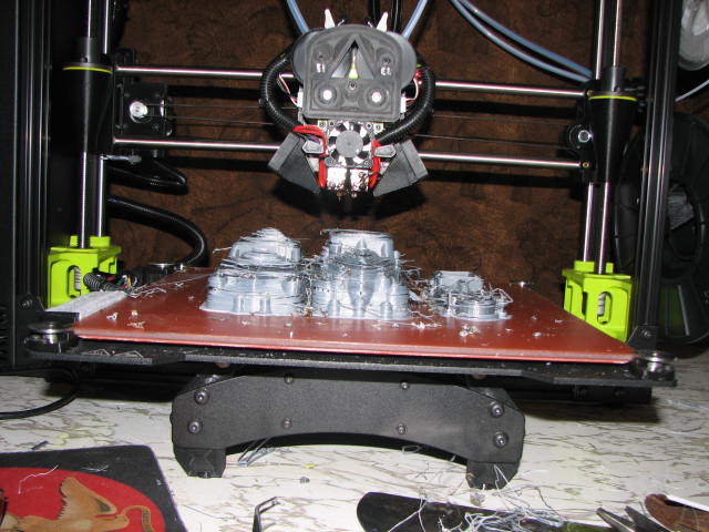

Sorry about that I should have posted this picture:
Running ABS in Extruder #1 on the left and HIPS in the extruder #2 on the right. Got lazy and used the chrome pen to label the extruders.
