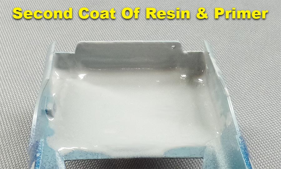

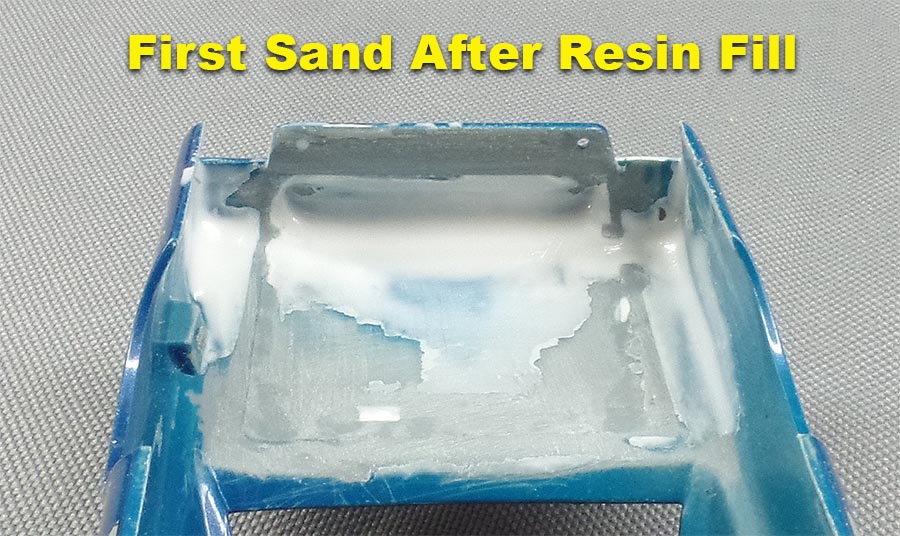

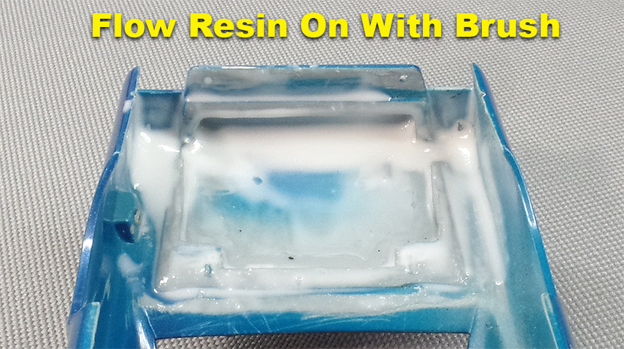

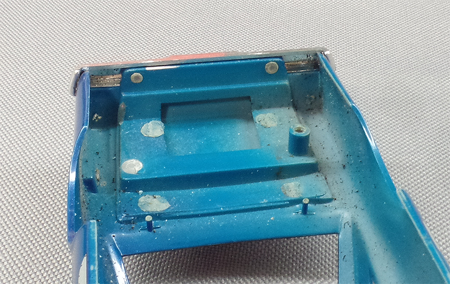

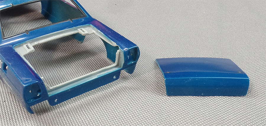

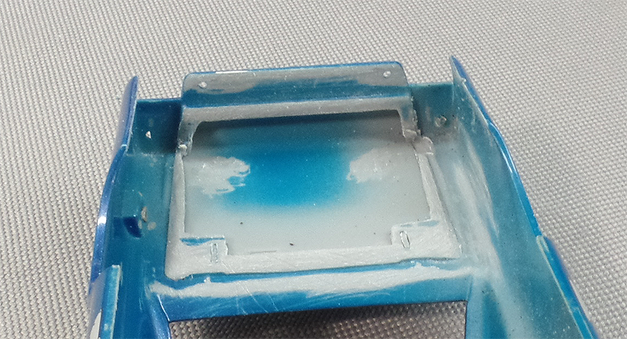

The rear of the body has a large structure that holds the trunk section. All of this needs to be sanded away and sealed for the mold, so here we go.
I thought I could just take away some of it, so I glued the trunk in place with Testors and then back sealed the area with resin. I used Smooth-On 65D and basically "painted" the area with resin using a disposable plastic paint brush.
That was not enough so I sanded it the rest of the way down and coated it once more with resin.
I sanded that and sealed with primer. Much smoother now and my inner plug mold will be cleaner and more uniform now.
Exciting huh? :whistle:
