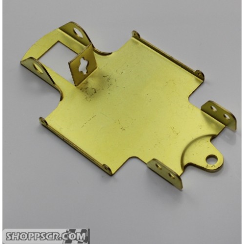

Postby turbokev » Sun Nov 23, 2014 9:47 pm
It is available as a bare chassis for $25 dollars. No bending required.
That's for the cut and modified womp brass chassis and the nerf bars pre installed.
No motor, axles, bushings etc. Just the modified chassis ready to build up.
There's a list of additional parts I used at the end of the first post up top..
Here's what you get if you order one.. the new chassis has the mounts cut and moved inward, and
all the brass tubing for the nerf bars is bent and installed.
Considering the amount of work that goes in to the stock $12.00 chassis to make it look like this, it is a bargain.
Stock chassis:
If you'd like to order one of the modified chassis, just send Vintage 1/24 a PM.
Thanks,
Kev
