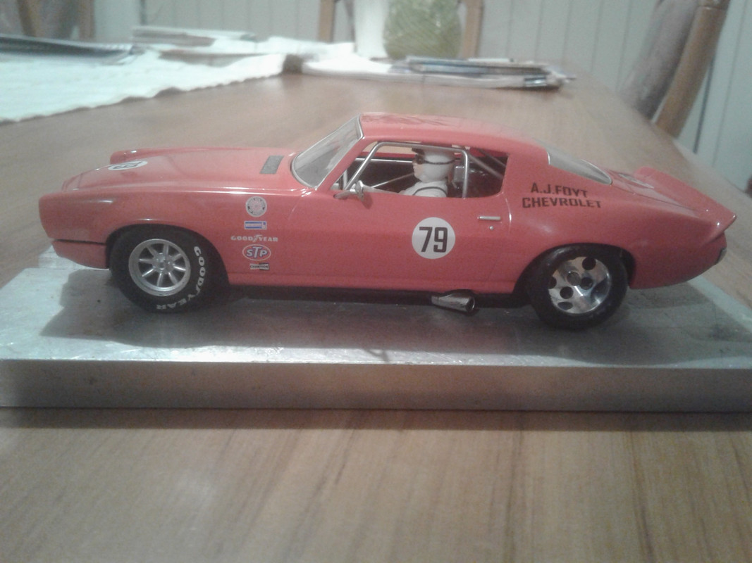

Hi all. I have just put together a Scaly Camaro for a new member. Have kept any changes to a minimum with slightly small front tyres, 5gms of lead, 12t pinion, 36t Slot-it spur gear, new axle-brass bearings-Ninco ali's and Slot-it N22 tyres glued and trued. It had first run last night and went really well. Will try and add photo.
