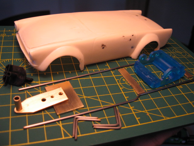

My first Sunbeam Tiger build was a simple inline motor layout so I'm curious on how a sidewinder with a wire chassis will compare.
viewtopic.php?f=45&t=15613
Had this resin body in the wings for awhile, so cut, prepped and gathered parts for the chassis.
- .055" piano wire for the main rails and front axle uprights
- .064 brass strips for the guide tongue and crossmembers
- 5/32" brass tubing for the guide post
- Scale Auto universal guide, 7mm deep
- 3DRon S can motor pod
Will roll on the same Mitoos 19mm and 17.7mm rims on homemade urethane tires as build 1.
