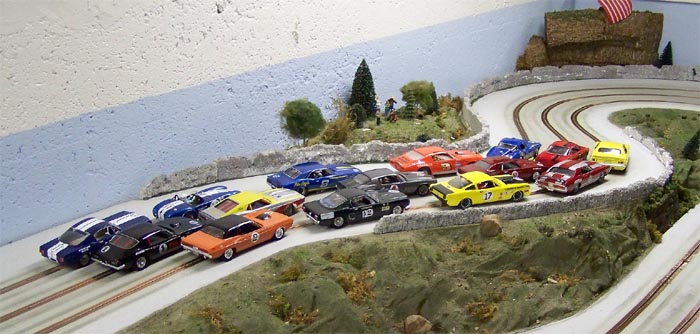

Postby HomeRacingWorld » Tue Sep 04, 2018 8:13 am
Bob, here is one shot of our series in 09.
I'll keep digging.
Re: 1/24 Trans Am series.
Postby btaylor » Tue Sep 04, 2018 8:32 am
Awesome line up Harry! I would love to see another proxy done in 1/24 or 1/25th scale Trans Am.
