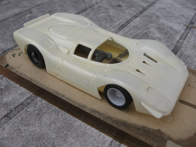

Postby VTECFOUR » Thu Aug 08, 2019 6:31 pm
Pendle order arrived in the mail, so got the chassis running.
Powered by a Scalextric Sport FF050 slim can, 25K and geared 3.33:1 with a Slot It 9t pinion and 30t crown gear.
Went with a tri-post body mounting, one front and one on each side pan.
Body sits low but with lots of tire wheel clearance.
Cosmetics to finish.

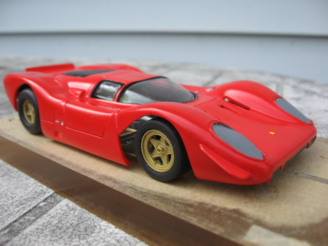

Postby VTECFOUR » Fri Aug 09, 2019 3:08 pm
@ Xr4ti - guide's a Sloting Plus Universal, 7mm, my go-to one these days. They're reasonably priced and include the power wire ferrules and top screw.
@ chappyman66 - the rear wheel/tires are my favorite set-up, F1 rims with trimmed and trued urethane copies of the Fly March rears. Love the bulbous sidewall profile and width.
Tamiya pink primer's on, ready for final coats of Tamiya Italian Red.
Wheel inserts are my own resin casts. The masters for 15mm and 17mm rims were done by Greater Vancouver Slot Car Club's resident 3D design and printing whiz, 3D Ron.
Dan

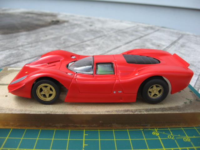

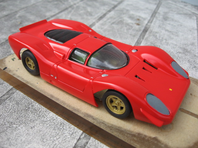

Postby VTECFOUR » Tue Aug 13, 2019 11:49 am
Final coats of Tamiya TS-8 Italian Red applied along with detail accents in flat black, silver, yellow and clear red and orange. All covered with Tamiya semi-gloss clear. Vac form window glued in too.
Worked out modelling and performance-wise.
Easily faster and more driveable than my other Ferrari 312P Coupe with the sidewinder set up.
Fastest of all three of my 312P builds.
Ferrari 312P Coupe build 1, Scalextric Sport 25K FF050, sidewinder, 95g total weight - 5.864 fastest lap
Ferrari 312P Coupe build 2, Scalextric Sport 25K FF050, inline, 83g total weight - 5.460 fastest lap
Ferrari 312P Spyder, Scalextric Sport 25K FF050, inline, 91g total weight - 5.556 fastest lap
The latter two are equipped with my favorite rear wheel/tire set up, F1 rims with trimmed and trued urethane copies of the Fly March F1 rears, so this looks to be a factor.
Good outcome.
